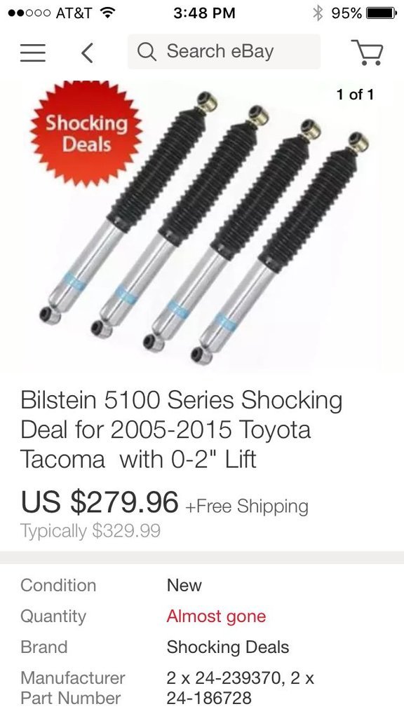

    Just wanting to confirm I bought these 5100s off of eBay from 4 wheel parts. These are the right models correct?. e84008173019fd88858dd1b6c1d8651a_72e7574a7eb010a7a8ac6da5d565d988fd3909a4.jpg
    I bought 887 s, diff drop, and taco lean spacer from headstrong
    I haven't decided on brand of aal and uca's yet. Just want to make sure I'm headed in the right direction thanks

    Pretty sure you're gonna need an UCA with 887's. I'm running 5100s with 885s and I'm maxed out alignment.
