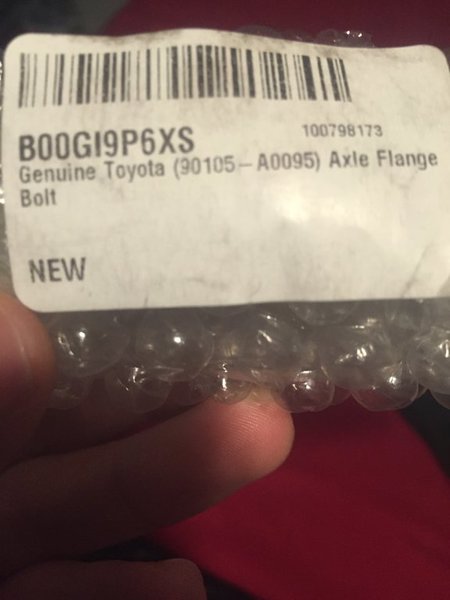

    Can somebody please tell me the part number for the UCA bolt. I have tried searching thru this thread but haven't had any luck. Thanks!

    ordered from Amazon for $36.40 shipped with tax.

    Got mine at the dealer couldn't find the part number either. 34$ for 2 bolts
