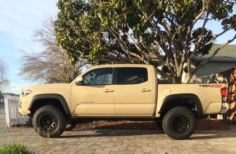

  6. Feb 10, 2016 at 9:45 AM
    #1166
    Taco Luvr
    Taco Luvr Well-Known Member
    Jan 18, 2016
    #175295
    355
    2016 TRD 4X4 OR
    King Ext, TC UCA, 1.5 AAL, VTX Rogue SL, BFG KO2 285/75R16
    OME 885's, no top plate spacers, driver side trim packer
    OME 90000 struts
    OME 60091 rear shocks
    Wheeler's progressive AAL 1.5"
    BFG A/T KO2 275/70R17
    Konig Six Shooter 17"x8" wheels 4.5" backspace, 0 offset
    Steps will stay on for now until I pick a set of sliders out. Easiest way to wash the damn thing!
    Love the way the truck handles vs stock

  7. Feb 10, 2016 at 1:27 PM
    #1167
    Malibu7tss
    Malibu7tss Can' t think of anything to type here right now.
    Jan 26, 2016
    #176180
    699
    Central pa.
    2016 trd sport dcsb 4x4 bbp 6spd manual
    Old man emu with 888's and headstrong off road progressive aal, trd pro wheel, Cooper Stt Pros 285/70r17
    Did you happen to measure before and after? I am considering the same springs.

  9. Feb 10, 2016 at 1:32 PM
    #1169
    Taco Luvr
    Jan 18, 2016
    #175295
    355
    2016 TRD 4X4 OR
    I did not measure before, and because I know the 885's settle quite a bit, I don't think an "after" measurement right now would be worth much. They were just installed yesterday.
    The lift is perfect for these 275's, but I would use a top plate spacer if going any larger.
  10. Feb 10, 2016 at 1:37 PM
    #1170
    Taco Luvr
    Jan 18, 2016
    #175295
    355
    2016 TRD 4X4 OR
    I can't say I feel any more bumps than I did with stock coils, shocks and tires. I drove it for about 1,500 miles before the lift was installed and I was already feeling plenty of bumps, it's just now these new shocks absorb the bumps better.
    I feel much less "sway" up front when turning on the new suspension. It's probably because the new coils and struts are a bit stiffer, so I'm getting less of a "roll" effect.
    The tires are E loaded tires, but I really enjoy the way it feels. Hard to explain. Maybe it's just my excitement, but OME seems to produce quality parts. This is the first l have ever lifted a truck.
  11. Feb 10, 2016 at 1:57 PM
    #1171
    sully3604
    sully3604 Member
    Dec 26, 2015
    #173134
    16
    Sean
    Massachusetts
    2016 DCSB SR5 4X4 Super White
    Mickey Thompson classic III BFG A/T KO 275/70/16
    Stock uca's? How were your alignment numbers?
  12. Feb 10, 2016 at 2:11 PM
    #1172
    Taco Luvr
    Jan 18, 2016
    #175295
    355
    2016 TRD 4X4 OR
    Stock UCA's. Camber could be better, but OK. Caster is fine. After coils settle I will address again.
    sully3604[QUOTED] likes this.
