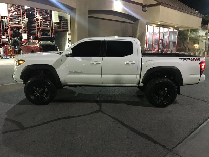

    I got the Toytec boss lift also. AAL in the rear, Total Chaos UCA. Truck is about 2.75 inches higher (on stock wheels and tires). Put on 17x8.5 wheels with Toyo 285/75/17 tires. Looks great. A little stiffer and it is noticeable. On street i haven't had any rubbing, but off road i get a slight rubber once in a while with the wheels cranked and the front end slams down hard. I'm going to look into shaving something if possible to reduce the rub.

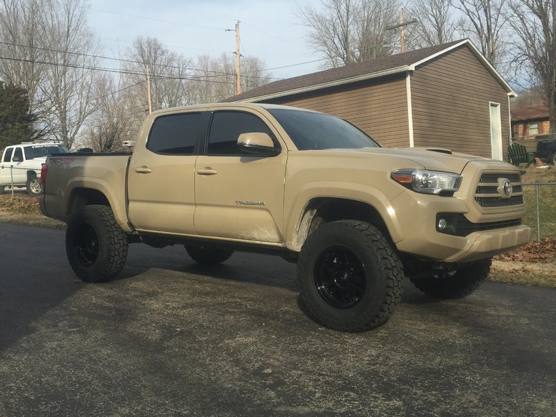

    OME Suspension Lift Deaver AAL Mickey Thompson ATZ P3 285/70r17 SCS Stealth 6 17x8.5 Spidertrax 1.25" Spacers LED interior lights Hella Supertone Horns
    wheels and tires installed. alignment was way out due to the lift.

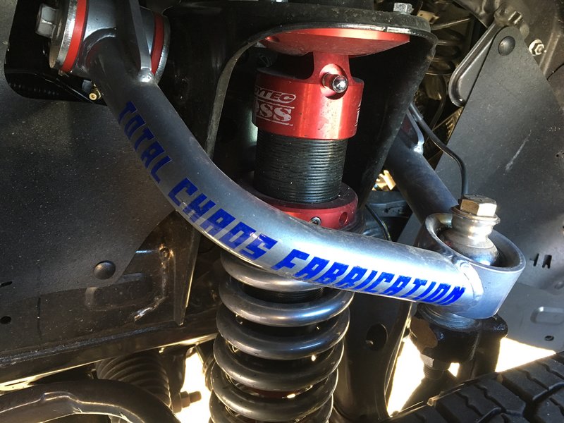

    So I am getting confused by mixed results here, so I'll just ask the question. I'm looking at the Boss complete kit from Toytech, yo that I am upgrading the rear with both 2" add a leafs as well as resavior shocks. In the front I would like to replace the UCA's, I'm leaning toward the total chaos, but don't know if I they are worth $300.00 more then the SPLC light racing arms. In the end I'm hoping to add the FNx wheels with 285 rubber. I can't figure out if I will need to add the 1" body lift to avoid rubbing, and would like to do this right once.

    I would say that SPC UCA's are a solid upgrade in terms of adjustability over the factory UCA's and the ball joint itself does have a good improvement in travel. However they are not a big increase in strength. If you are after a UCA that is stronger and can stand up to a lot more abuse than what the factory stuff would handle. Total Chaos all the way.
