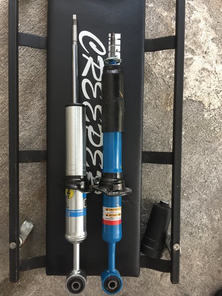

    xTacoma16x
    xTacoma16x Well-Known Member
    Dec 10, 2015
    #171934
    227
    TRD sport 2016
    You probably could but that's just more work, doin it twice. Stock shocks are a bit shorter than 5100 I don't know if you would be able to thread top nut using truck weight method, It may be doable. Or just use sring compressor.
    Here is pic of stock and 5100
