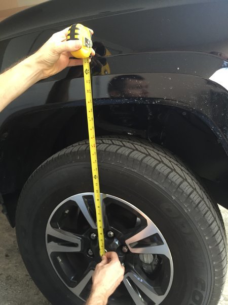

    Hey yal this is my first post here on this forum! This is also my first yota! I just bought a 2016 Tacoma black double cab 2wd sr5 "XP Rockstar package" all stock except window tint lol 20160307_180331.jpg2016-03-04 15.41.16.jpg
    I'm loving this truck but I'm used to big trucks and big tires. With the 3" pro comp lift and 285/70r17s, how is your ride comfort and do you have much power/mpg loss?
