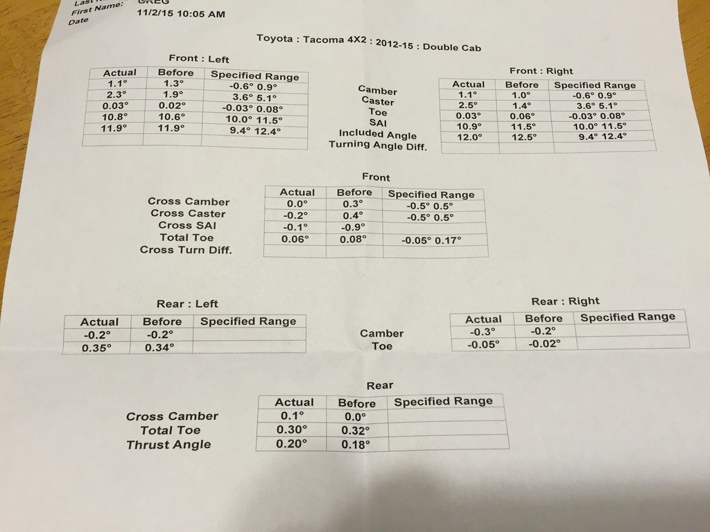

    Took it to the alignment shop this morning to no avail. They couldn't find the specs for a 2016 Tacoma and said something about the difference in weight with the motors from '15 to '16 and didn't want to chance it. Anyhow, at least they owned up and said they'd rather not take a chance and screw it up. I ended up calling up my local Toyota service department and they said they could do it for $70 on Monday. Once I have it done I'll report back with specs.

    are you guys getting alignments after lifting with struts?
    oh, well, there you go

    Now see? This is a good/helpful ,post thread. It'll give others some no.#'s to go by when you report back & $70 from a dealer is a great price... props to you Deano...;)
    ya should do that when ever you change ride height,etc;...

    Took it to Toyota today for an alignment. They actually went off 2015 Tacoma specs. My biggest issue is camber because I'm set at 1.75. I will be bringing it back down to .85 and would suggest the same to anyone putting 5100s on a 2016 with stock UCAs. They maxed out the camber and caster as much as they could and it's still a tad slightly off, but within safe driving conditions Everything else they could get within spec.

    Thanks for that,, wondering if that now is because of the 1" lift they themselves put on it?? Adding your 1.75 bringing up to 3" basically ,, where you need the new ucas ,, is that correct,,??

    The way I am looking at this you can lift approx 1" on the stock front end and still get within OEM spec on the alignment. Anything more lift wise without changing suspension components will not yield a within spec alignment. Does this sound correct?
