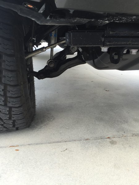

    So do you have any pics of your front upper and lower control arms? I know you don't have a CV in there but I am curious how close the factory bumpstop is to the strike plate sitting at 24.5" of lift.

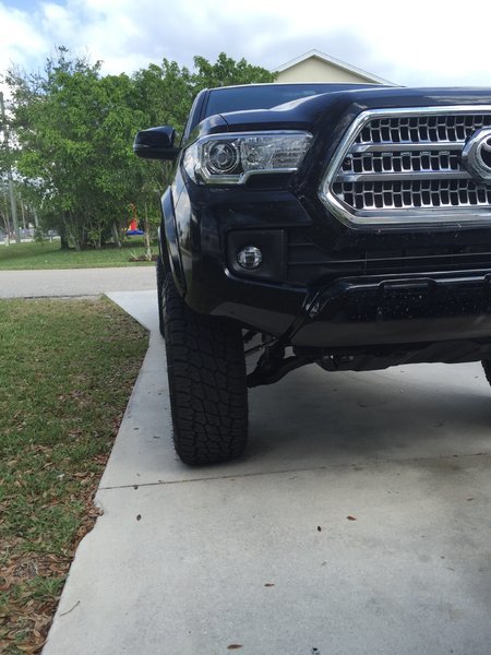

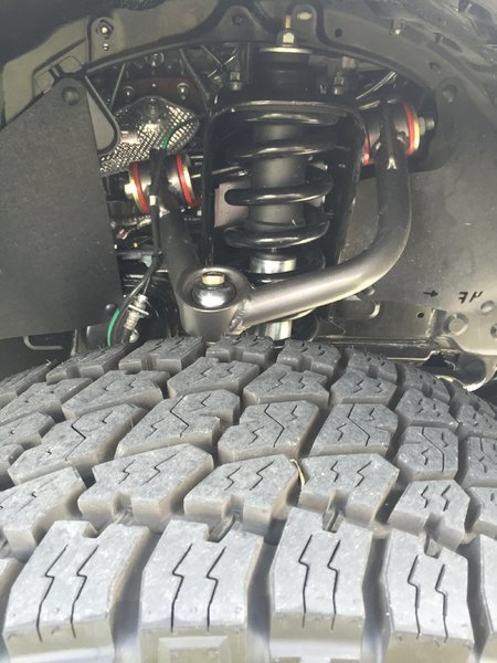

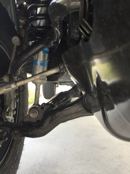

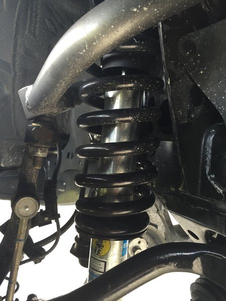

    Took few pics for you.

    So from what I can see you have no down travel at all. If you were to Jack up the front do the tires move down at all? Be thankfully you don't have CV's. Note the angle of your steering tie rod... your CV would be sitting at about that angle. It should be damn near binding or possibly. The shock is probaby topped out. Be really careful dropping off of curbs or ledges at a high rate of speed.
    Personally I would lower that back down to the "0" setting. Your shocks, uniballs tie rod ends and lower ball joints would all thank you.

    @Gramps How would he correct that extreme angle on the control arm while maintaining that height? A spindle upgrade ?

    As a pre runner, he could get lift spindles, camburg or maxtrack. Those should give roughly 3 inches of lift by themselves so he'd have to put the factory coils on the 5100's set at 0. Any lift coils paired with the lift spindles would result in some excessive angles on the uca/lca/tie rod end links.
    Edit: I haven't seen anyone do this on the 3rd gen yet, and if I remember correctly the maxtrack spindles gave the 2nd gens 4 inches of lift up front, so I am just guessing at 3 inches of lift on a 3rd gen. Uca's and lcas will almost be dead flat though.

    Yeah, zero setting was good amount of lift. But then I got non adjustable ucas, wheels started to rub on cab mount because lots of caster, didn't like how my truck handle with so much of added caster so I decided to bump one notch. I kick my self in the head everyday for not doing spindle lift. It starter that I just wanted to level with 5100 at .85 with stock coils, then found out that stock spring won't work well...so one thing lead to another and now I'm at 3.5" lift...lol
    When jacking up the truck it will go up about 3-4" before wheels lift off. I don't worry about shocks being topped out, I don't off-road or jump curbs, and ever if anything go wrong I can fix it, worked on my cars/trucks/motorcycles/boats all the time, newer trust anyone to wrench for me.
    Now my rear sitting lower, thinking doing 1.5" AAL and 1" blocks with 3 degree shims. Now it has 2" blocks. What really pisses me of is that driver side is 1/2" lower with full tank of gas, hoping AAL will help with that

    I would strongly consider getting SPC UCA'S. Even with 2"s of lift your upper arm will not be in the optimal position to get your alignment correct. Also I sent you a PM regarding your purchase options.
