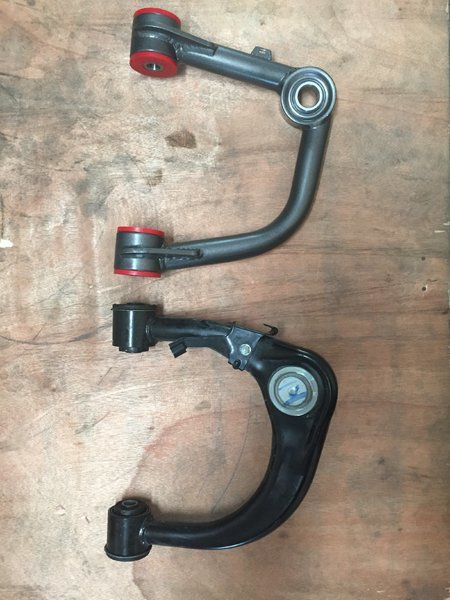

    I understand how to align a truck, I'm asking the difference in an adjustable uca and a non-adjustable uca. What's the difference if I had the two control arms side by side?

    SPC adjustable ucas, and black stock non adj, grey non adj, same goes for camburg, TC...etc. adjustment are made on upper ball joint.

    ahhhh I haven't seen them. I think id feel better on the trail with heims as opposed to a traditional BJ.
