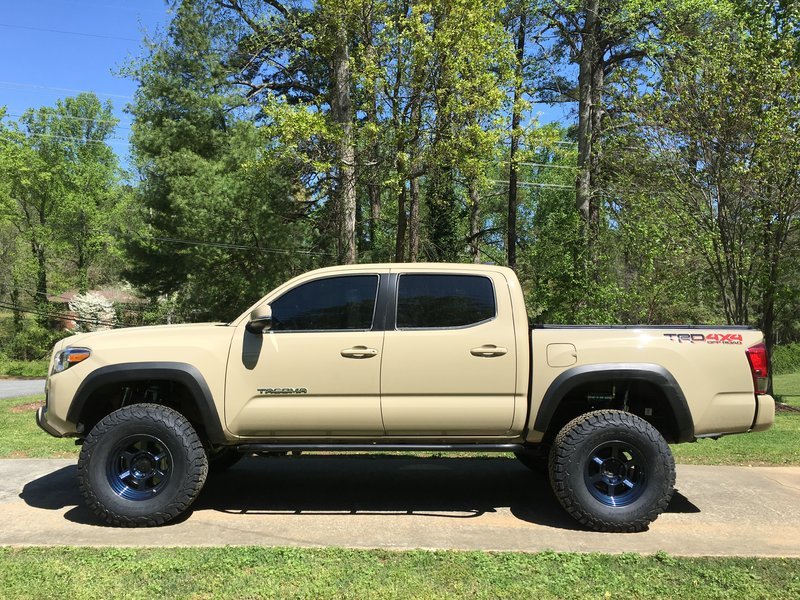

    I finally lifted the Tacoma over the weekend and much happier with it now. I want to thank Micah at Down South Motorsports for helping me get all setup. I went with the King coilovers/shocks and the OME Dakar leaf spring pack in the rear. I reused my TE37's that I had on my FJ but installed a fresh set of 285/75/16 BFG K02's. I also installed a set of All-Pro's rock sliders for safety when we go trail riding.

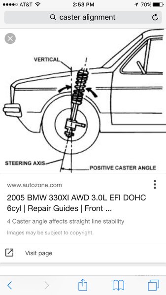

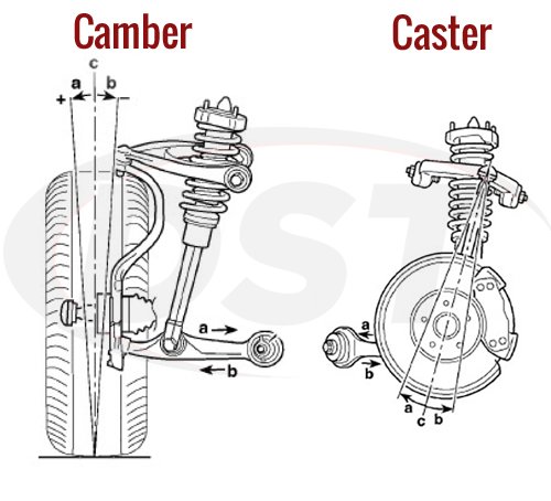

    They would not be able to correct it and put it in factory specs of 1.8 degree, they could probably add more caster to move your wheel forward to clear from rubbing, but that just way out of spec as its already 2 degree out. You would want 2.5 degree this would still be within factory specs.
    It's really easy to understand caster if you look at this pictures, TC UCAs provide more caster by moving top point of spindle towards cab, to fix rubbing you would want to move wheel forward on lower arm this would create more caster degree, so it's not like you need lots of caster to clear your wheels from rubbing. This whole idea with adding more caster is only to clear wheels, it's not like the more caster you get the better it will ride, kind of opposite. 3rd gen comes with 1" lift with new upper and lower arms designed from factory to put you alignment in factory specs while keeping your cam bolt setting at zero. So using 2nd gen parts is not ideal in this case, or you would need more lift, true 3" from stock...but then you would run in more problems by having to much lift.

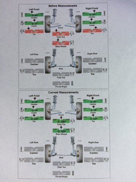

    This is perfect alignment, I can tell that people that did this know what they were doing. You can see that they had to sacrifice .5 degree camber to put caster in 2.4 degree witch is totally fine. Also set toe in(positive) .04 this is ideal for RWD vehicle.
