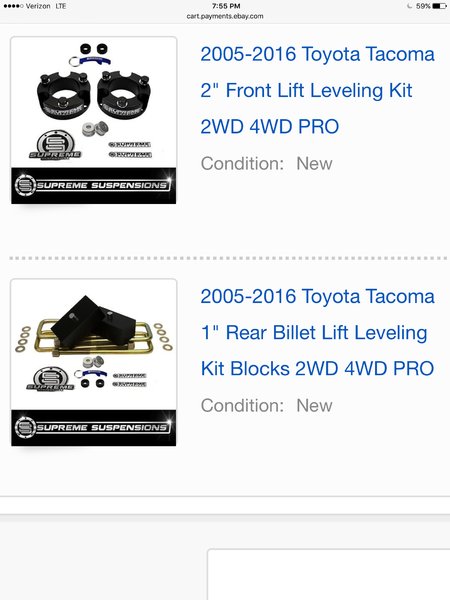

    Well, to put it bluntly.... If you only care about looks, over ride quality and performance, then yes, it will give you a lift and allow you to run larger tires, however that's where the benefits strop. Spacers are known to cause a rough ride, premature component failure and certainly not offer you any increased performance what so ever. I know the dealer installs and sells these kits, however I think we can all agree that what the dealer does to sell a car isn't always in the best interest of the buyer..
    Anyhow, that's just my two cents..

    That's why I'm asking, I'm new and I don't know too much. I thank you for your opinion and everyone else. I don't plan on going off road any time soon. Im not even going to change the rims just tires maybe ST Maxx or KO2 and maybe 1 size larger 275 X 75 or 70 X 16. So yes I'm going for looks, something good in the snow, and maybe some dirt roads.

    It's fine to run spacer lift you know the consequence. As long as you don't flex your suspention much it's ok. But if you buttom out front strut, running curb or even hole in dirt road you can snap your shock in half and leave you stranded. I would suggest do more research before you commit to spaser lift.
