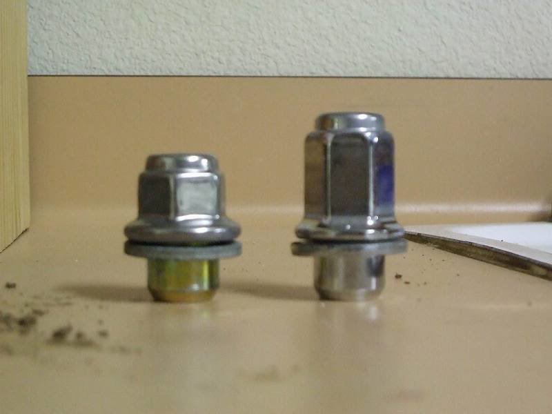

    There are 2 different lengths. They'll both work, as they have the same thread engagement. But some wheels have deep lug wells....some are more shallow. So it's just a matter of aesthetics. My experience says go with the shorter one when in doubt.
    Also....notice these shank style nuts have a tapered bottom to accommodate your steel spare wheel.
