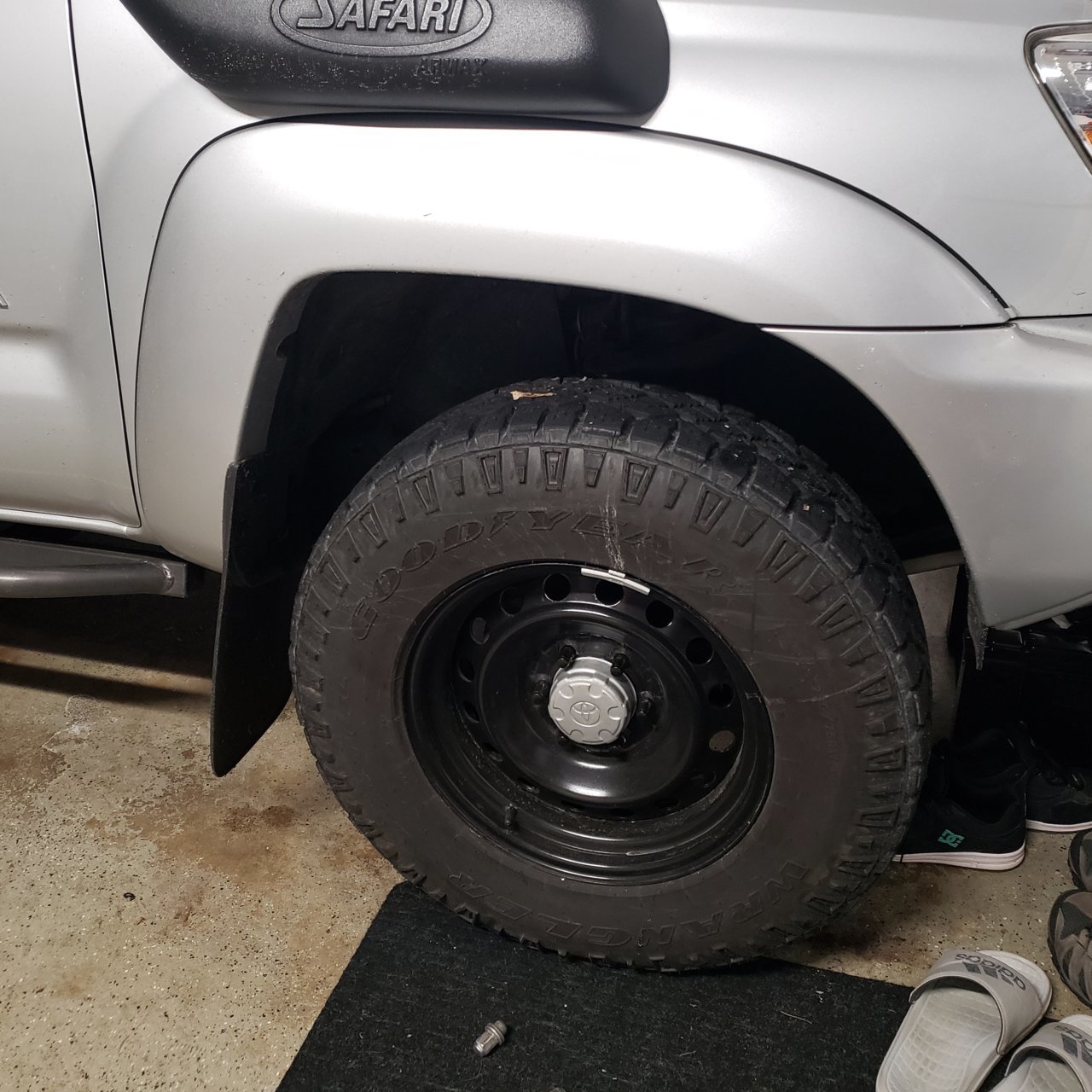

    Those will work fine. They have a tapered end. But a simple acorn lug nut is your best bet....as far as looks.

    These take a mag seat lug. The lug has a shank that goes into the wheel.

    not sure if someone mentioned this but the OEM lugs you have are for the steel OEM rims which I’m assuming come stock on the SRs. The other OEM lugs people are referring to are the OEM lugs that come with the alloy OR or sport rims.

    Its because the steel wheeled SR trucks come with good ole fashion acorn style lugs. When I got TRD PRO wheels during that crazy sale they had a while back, I had to order the mag style lugs too. I keep 6 original ones in my center console because I wasnt too sure about mounting the spare with them, but apparently you can use the mag wheel lugs on the spare due to the bottom being tapered. I didnt even notice, back to the tool box those go!

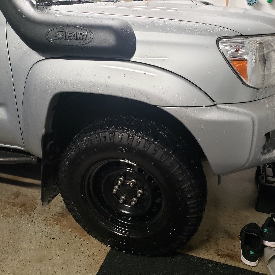

    I’ve seen this in my 2010 when I put level 8 mk6 with a zero offset on. I got gorilla lugs With them and I was only able to spin on one or two spins and they were tight but almost no thread engagement, I purchased longer studs and that solved the problem. Not a terrible job and not too expensive.

    Yes you can. We OR and Sport people would be in trouble if that weren't the case. We all have steel spare wheels. :thumbsup:

    It sure will. With mag seat lugs the lug shank goes into the wheel and threads on to the studs.

    It's all good. OP went from an OEM steel wheel with acorn style lug nuts to an OEM alloy wheel. The alloy has a much thicker hat and requires the OEM shank nut that protrudes into the lug well engaging the threads, as well as having a washer to distribute the load evenly over the wheel hat.

    So when I head over to my local dealer and grab those OEM lugs, is shank nut/mag seat lug the correct terminology?

    Yep, just say you need oem mag seat lug nuts.
