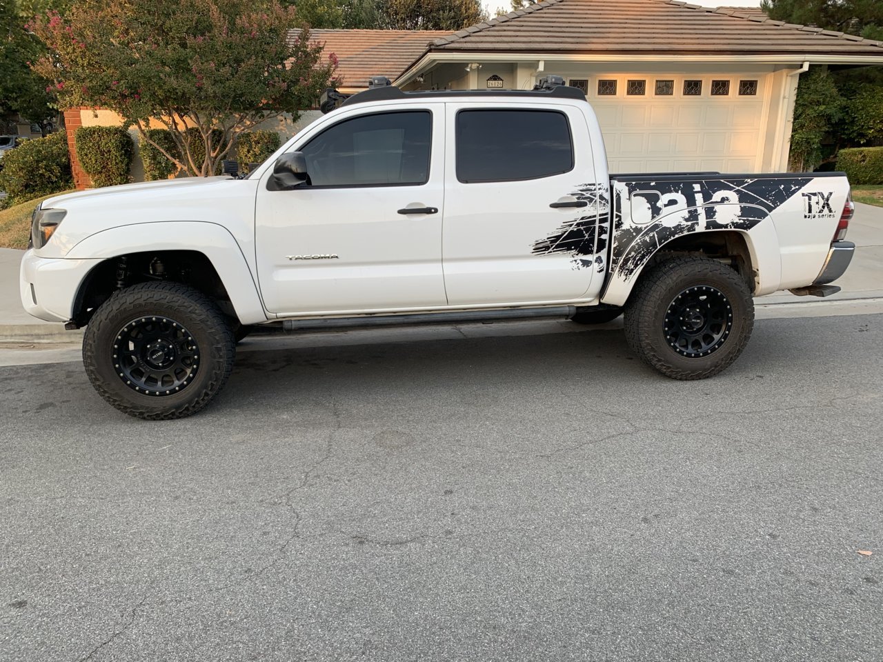

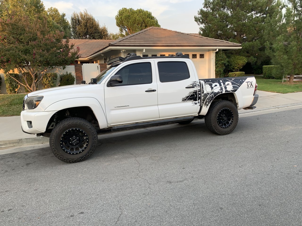

    I mean I pulled up tech specs and called icon tech people to verify about where mine stands and their recommendations and they said 2.13” is max and under 2” not gonna give me the best ride quality. But yes your right about the confusion because I was confused myself when they said to put in between 2” and 2.13”

    You level or raked front to back? Adding a heavy to the front will be negative results on the springs at that preload, how’d the CV angles look?
