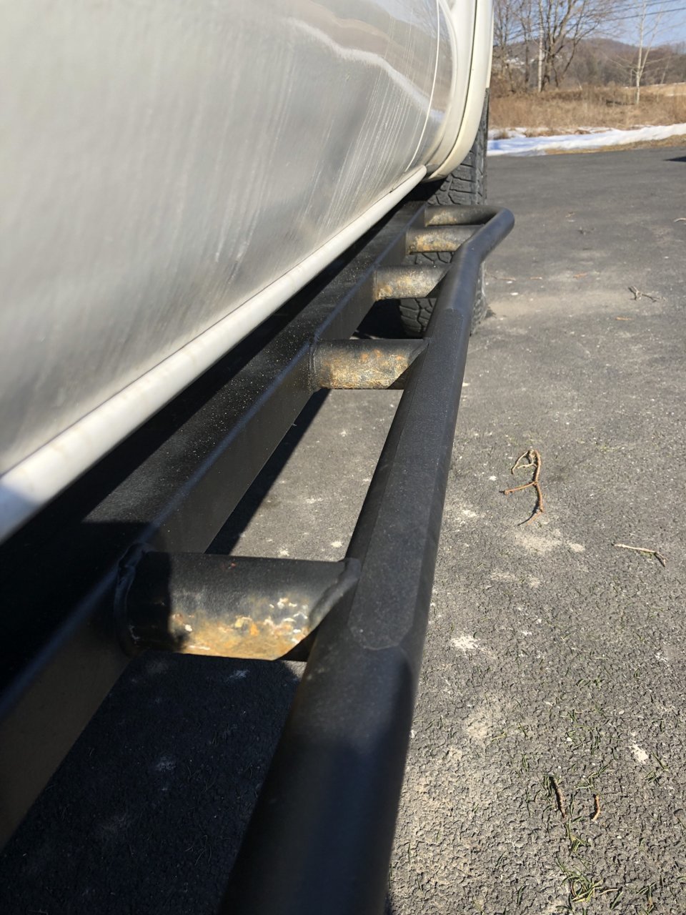

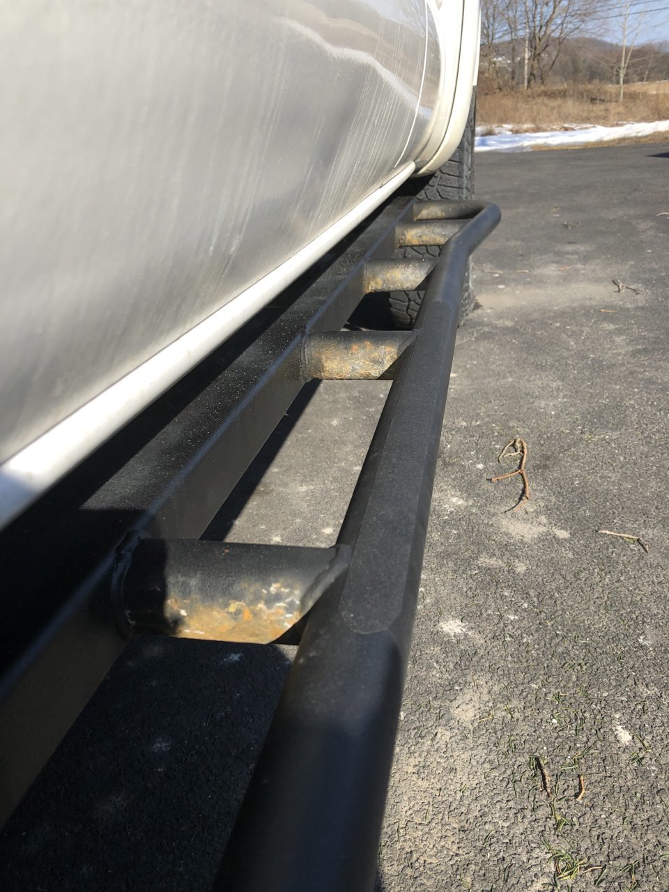

    I just love living in a salt shaker :mad::mad::mad:
  9. Mar 3, 2021 at 8:22 AM
    buffedout

  10. Mar 3, 2021 at 8:22 AM
    lynyrd3
    Apr 9, 2008
    #5848
    35,537
    Bill
    East Central Upstate NY
    I just cleaned and repainted these in the late summer :annoyed:

    If it's any consolation ours are dinged up and need a good paint and we rarely touch salt. My .02 is it just comes with the territory of having ones that aren't aggressively powder coated :notsure:

    These came bare from Mobtown Off-road . My guy sent them out to be sandblasted then he powder coated them . Every year I clean them up and spray with Rustoleum rust reformer then spray with bed liner . They are 3 years old :(

    Bed liner...Had mine done 2 years ago and no chips and no rust. I drive gravel roads a lot and we have a lot of salt.

    The shop I use has a huge Powder coat booth . A year after they were starting to get surface rust and the shop owner told me PC has a hard time clinging to curved areas :facepalm: If I knew that I would have just primed and painted with rattle cans :annoyed:

    Mine were powder coated first then I spray rust reformer,then bed liner .

    I wouldn't have guessed those were powder coated :anonymous:
    Ours were bare from bamf and we just rattle canned them over a few days.
    Maybe when you respray them this year try putting tape on those heavily hit areas for added protection?

    If they were not welded on I would send them out to be blasted again .

    Time to find a new powdercoater. Powercoat sticks to almost any surface, prepwork is key.
