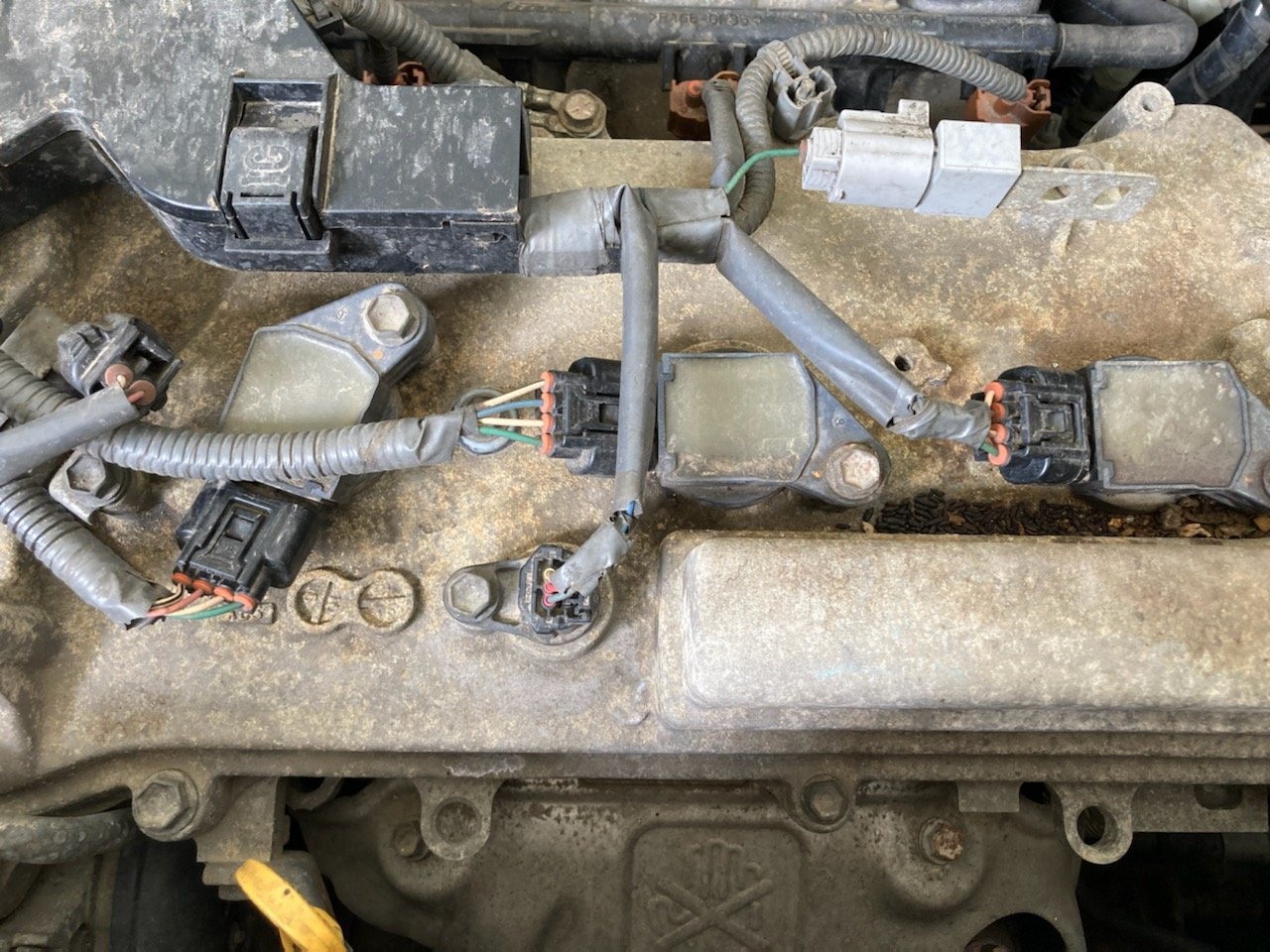

    Hmmm. I'll get a picture of the coils. I figured I would need to take a bunch off to get to the back 3 plugs with the orientation of the motor in the vehicle.
    Why the locking extension?

    Here's the front coils.
    What about Trans and coolant flush? Should I do those with 145k on the trip?

    So the socket isn’t stuck on the plug at the bottom of the tube… it happens

    Ok you’ve got the good style coils.
    coolant yes, trans yes. Fair warning on the coolant, it’s a bitch to bleed if you’ve got the rear heat

    Oh! For putting the new plugs back in. Got it.
    I can do coils and plugs, but I'll probably have a professional do the trans and coolant. Any thing else I should do for a tune up?

    Intake manifold gaskets. That’s about it.
    be warned there’s 2 brackets at the back of the intake that’s a little bit of a bear to remove.
