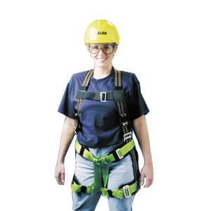

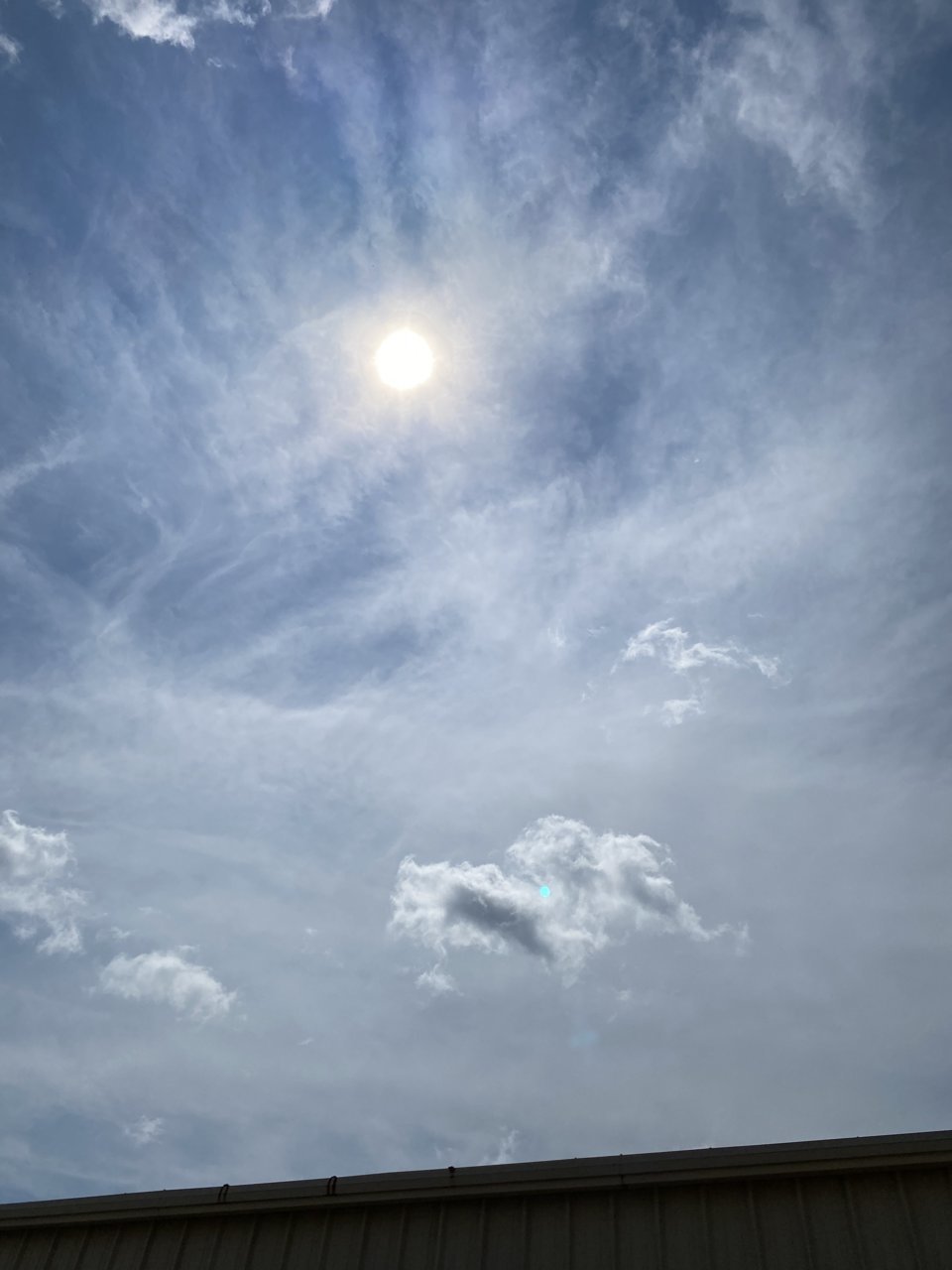

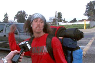

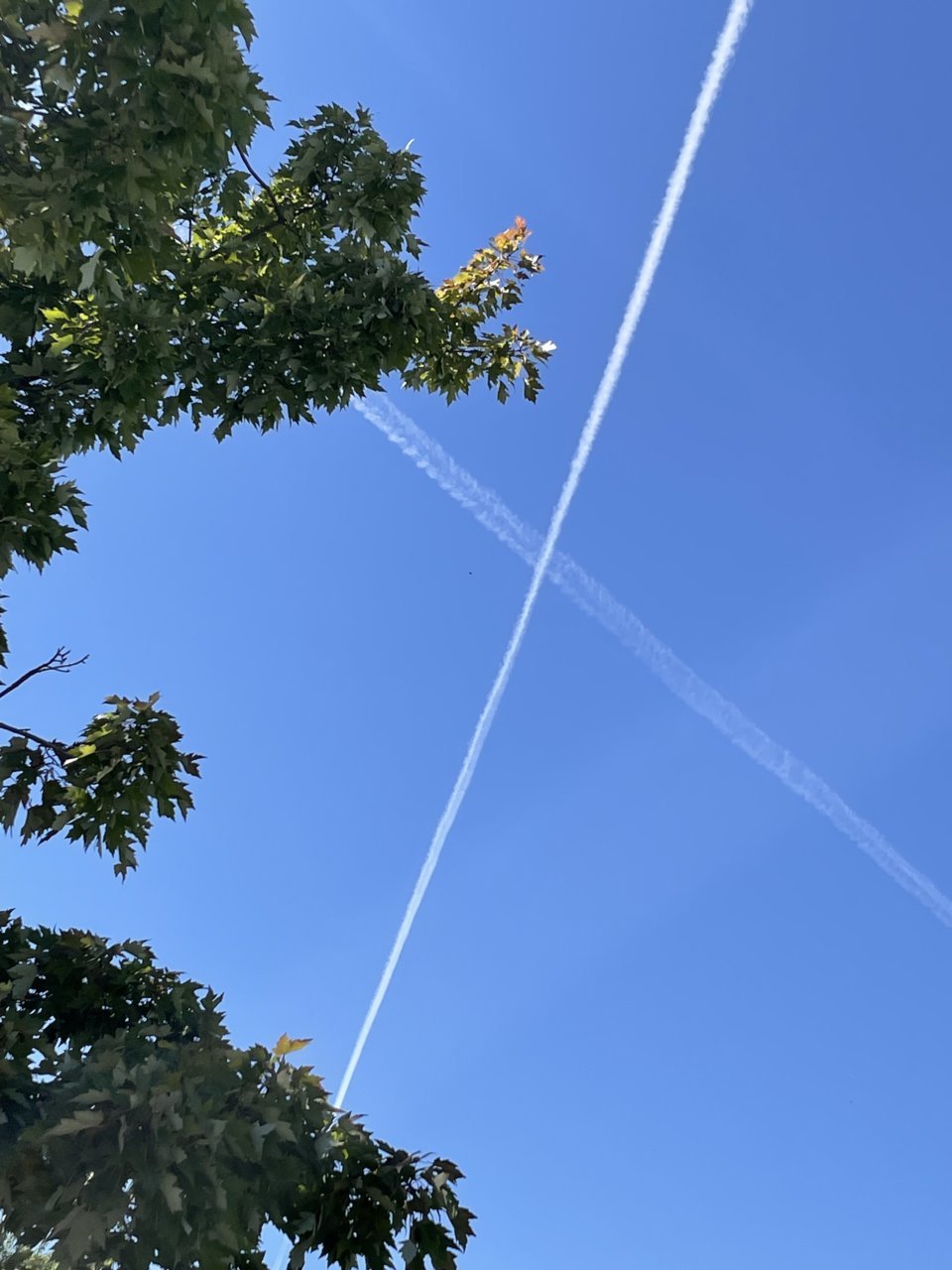

Whatever
Weed?
  1. Yes
    31.0%
  2. No
    20.7%
  3. I Don't Smoke But Also Don't Care
    48.3%
  1. Aug 2, 2022 at 8:55 AM
    Squirt
    Squirt Samsung Aficionado!
    May 5, 2020
    #326856
    9,713
    Ben
    Cornfields of Illinois
    2016 F150 Lariat with 3.5L of fury!!
    Rexing front and rear dash camera, some LEDs, Weathertech HP floor liners/vent shades/bug deflector/underseat storage bin, OEM Ford bed mat, Diode Dynamics SS3 Pros in selective yellow, Diode Dynamics 18" light bar in amber and universal Carhartt seat covers. Bak Revolver X4S tonneau cover. Android Auto USB plug upgrade! H11 to H9. Sound deadened/insulated floors and rear wall. VLED license plate reverse light. Yokohama GO15s. Rokblokz mud flaps. "Custom" 3in Flowmaster Super 50 Series cat back with a 3in Speedys Snap resonator. J&L catch can. AMP Powersteps
    No. Nope. No thank ya:facepalm:
  2. Aug 2, 2022 at 8:55 AM
    Delta09
    Delta09 Requires Supervision
    Apr 29, 2019
    #291677
    13,255
    Adam
    South Central PA
    2024 SR5 DCSB 4WD
  3. Aug 2, 2022 at 8:57 AM
    Delta09
    Delta09 Requires Supervision
    Apr 29, 2019
    #291677
    13,255
    Adam
    South Central PA
    2024 SR5 DCSB 4WD
    Not quite as good as red rockets :evil:
  4. Aug 2, 2022 at 8:57 AM
    MQQSE
    MQQSE I take naps
    May 6, 2010
    #36646
    54,099
    MooseMan
    Palmer, Alaska
    "Stitch" & "Sumbitch"
    Fine.
    Damn kids.
    :laughing:
    Well, I'm packing my bag and heading to the mtn. Ya'll be smart and don't get caught. ;)
    See Ya :hattip:
  5. Aug 2, 2022 at 8:58 AM
    Red Mud Ray
    Apr 26, 2018
    #251771
    666
    Darla Belle
    why?
  6. Aug 2, 2022 at 9:02 AM
    HoboDave
    Mar 16, 2017
    #213491
    5,902
    David
    Carlsbad, New Mexico
    2023 Toyota Prius
    Be careful up there. Remember what happened to Hatchet Jack.
  7. Aug 2, 2022 at 9:08 AM
    six5crèéd
    six5crèéd Be the light
    Jul 9, 2019
    #298734
    35,983
    Southern Virginia
    8 lugs no plugs
    StayinStock, tclavell, Squirt and 4 others like this.
  8. Aug 2, 2022 at 9:08 AM
    FishnTx
    Mar 22, 2017
    #214004
    9,173
    South East Texas
    ‘17 OR
  9. Aug 2, 2022 at 9:10 AM
    six5crèéd
    six5crèéd Be the light
    Jul 9, 2019
    #298734
    35,983
    Southern Virginia
    8 lugs no plugs
    Hard bein da boss?
    StayinStock, tclavell, Squirt and 4 others like this.
  10. Aug 2, 2022 at 9:11 AM
    FishnTx
    Mar 22, 2017
    #214004
    9,173
    South East Texas
    ‘17 OR
    Eets is!!!
  11. Aug 2, 2022 at 9:12 AM
    six5crèéd
    six5crèéd Be the light
    Jul 9, 2019
    #298734
    35,983
    Southern Virginia
    8 lugs no plugs
    But dat big fat paychek make up fur it, rite?
  12. Aug 2, 2022 at 9:14 AM
    FishnTx
    Mar 22, 2017
    #214004
    9,173
    South East Texas
    ‘17 OR
    Always be fatter!!!! Butt Ot now is worth eet!
  13. Aug 2, 2022 at 9:14 AM
    six5crèéd
    six5crèéd Be the light
    Jul 9, 2019
    #298734
    35,983
    Southern Virginia
    8 lugs no plugs
    I think I see your rocket coming down over here on the east side :cool:
  14. Aug 2, 2022 at 9:17 AM
    FastEddy59
    FastEddy59 TTC #0061
    Jan 20, 2017
    #208155
    27,141
    Eddie
    '13 Barc. Red Tacoma SR5 4X4
    X marks the spot. :D
  15. Aug 2, 2022 at 9:18 AM
    Delta09
    Delta09 Requires Supervision
    Apr 29, 2019
    #291677
    13,255
    Adam
    South Central PA
    2024 SR5 DCSB 4WD
  16. Aug 2, 2022 at 9:20 AM
    Red Mud Ray
    Apr 26, 2018
    #251771
    666
    Darla Belle
    StayinStock, tclavell, Squirt and 2 others like this.
  17. Aug 2, 2022 at 9:37 AM
    HoboDave
    Mar 16, 2017
    #213491
    5,902
    David
    Carlsbad, New Mexico
    2023 Toyota Prius
    So, regular unleaded is down to $3.85 here. How is everyone else looking?
  18. Aug 2, 2022 at 9:38 AM
    1buzzbait
    Nov 7, 2015
    #168925
    8,397
    Murph
    murrilin
    98 yamaha grizzly
  19. Aug 2, 2022 at 9:40 AM
    six5crèéd
    six5crèéd Be the light
    Jul 9, 2019
    #298734
    35,983
    Southern Virginia
    8 lugs no plugs
    $3.88 here.
  20. Aug 2, 2022 at 9:40 AM
    Delta09
    Delta09 Requires Supervision
    Apr 29, 2019
    #291677
    13,255
    Adam
    South Central PA
    2024 SR5 DCSB 4WD
    $4.45 here in PA, $4.19 just across the border in MD.
