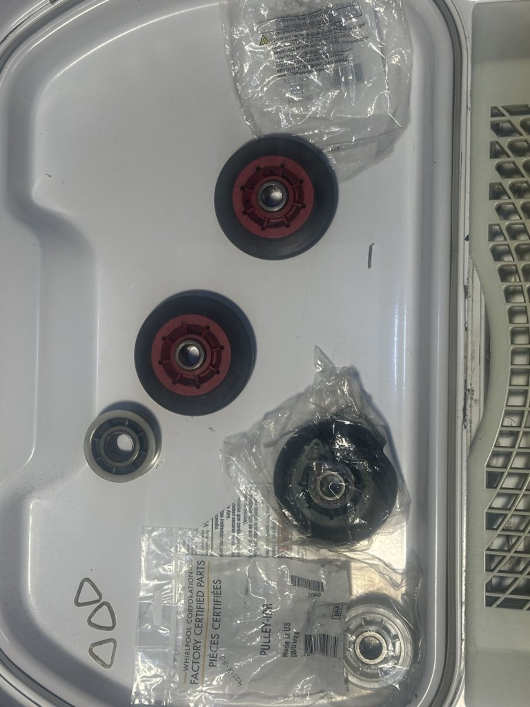

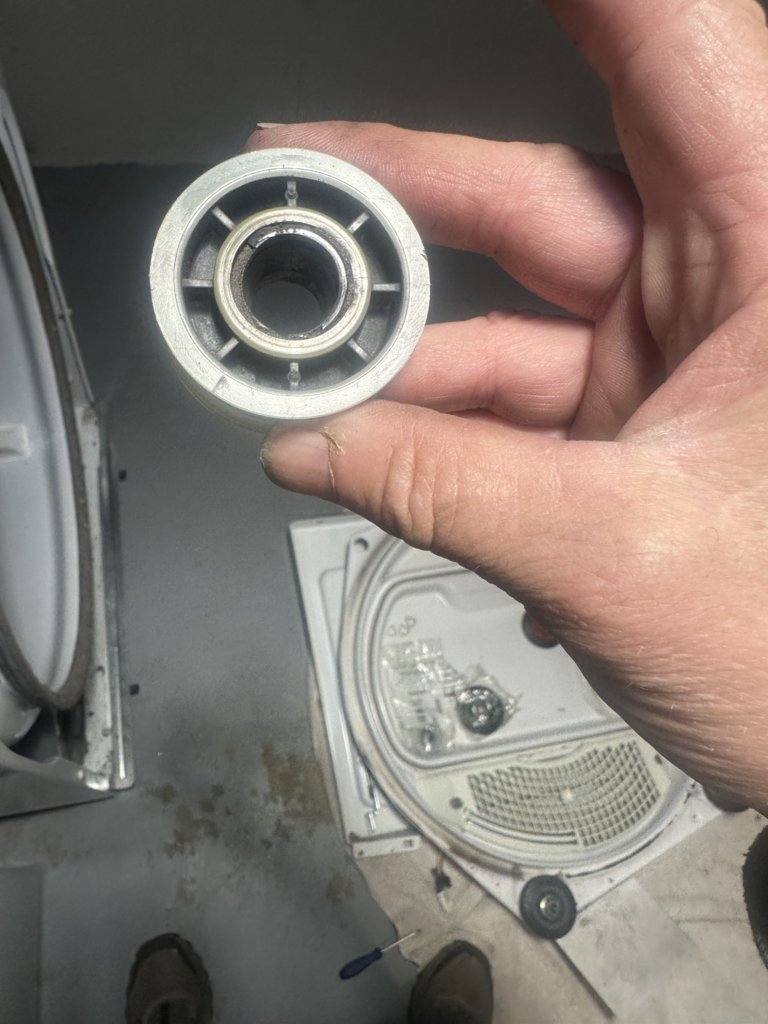

    Okay, back at eet wif the dryah…..
    Changing drum rollers and idler pulley. Pulley is beat to shit rollers aren’t too too bad but figgered what the heck. Deep down I wish I had gotten a new spring and or the whole assembly which was pretty cheap. Taking this thing apart is really easy so if spring craps out I thing I’ll be ok. Took about 15 minutes to disassemble…..
    This part was also needed :burp:
    Will report back later……
    Have a gewd day :headbang:

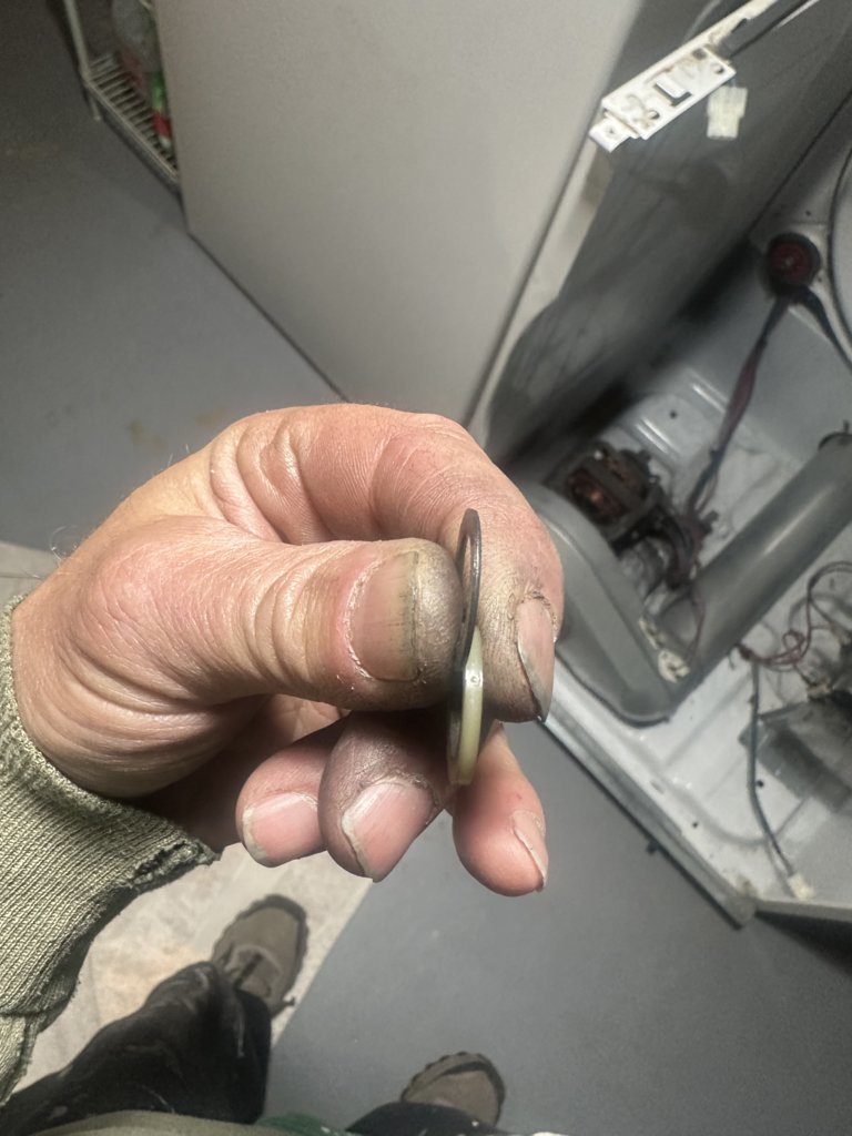

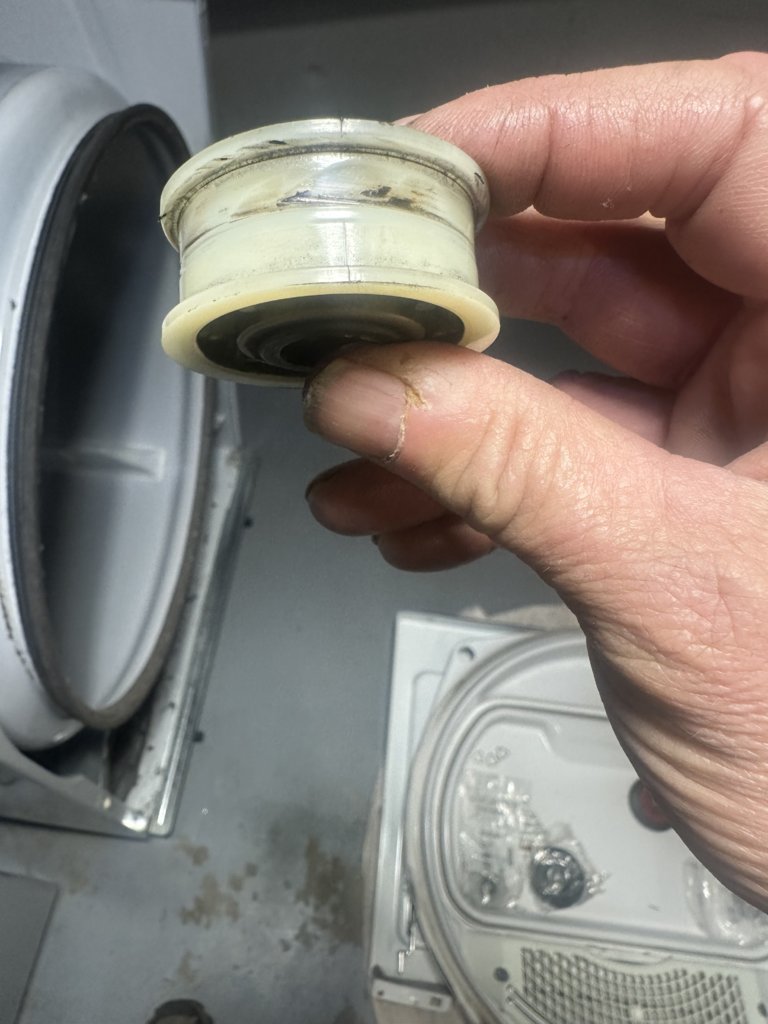

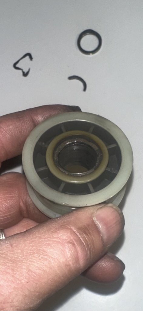

    After removing drum I found these metal pieces of idler

    Yeay! Yea, most appliances are durable except for the electronics. I had a friend who got tired of the BS and replaced his washer/dryer with a new ‘old school’ type, where everything is mechanical.

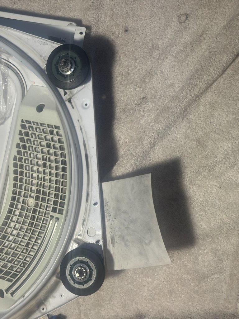

    You really can’t go wrong actually. Current debating on whether I should keep/ use the original nylon washer/ spacer versus the thin metal one that came with the pulley. I’m thinking it will keep proper alignment with the belt and it looks to be in good condition

    I’m with you.. as long as it isn’t brittle and doesn’t have gouges. I’d consider lubricating it or at least graphite.

    I’d guess you vacuumed/cleaned the fan assembly, since you have access to it. Typically it’s not very accessible with that strong angle form the lint trap. I’ve had mostly belts and ignitor failures in the past. Only once was a valve (they fail shut).
