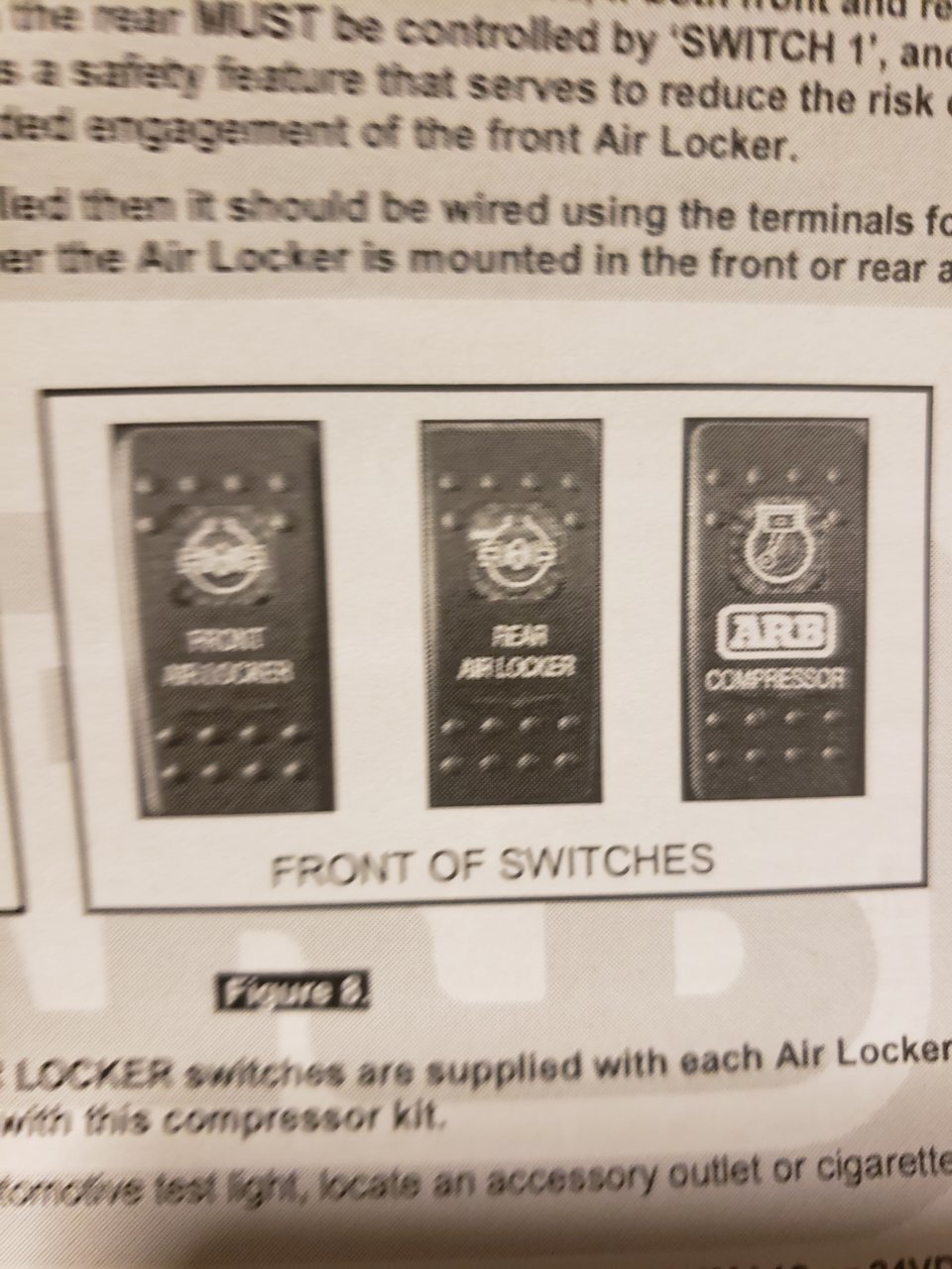

    i see it now. im so use to staring at factory diagrams its odd seeing it in black and white. So your not using a front locker we can knock that switch out completely. Im going to pull up the photo in paint and see what i can figure out witch wise. I assume you switches are also 5 pole like the ARB ones. (looks like it in the photos)

    OK so. run igition power to isolator switch on PIN 2, from there Pin 6 should be your illumination circuit, 7 and 8 are ground, Pin 3 will send power to pin 2 on the locker switch, 6 7 and 8 should be same as the other switch, that wire from pin 3 should T off to the compressor pressure switch. Pin 3 from the locker switch should then go to solenoid # 1

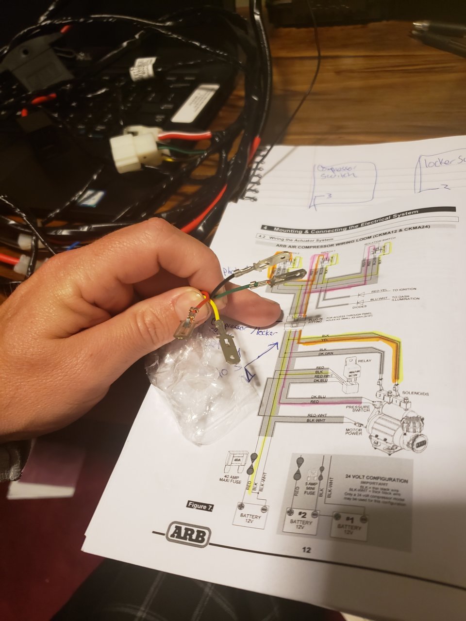

    [​IMG] less confusing looking now.. your yellow wire you have covered, your red-yellow is also already done, and your blue-white is already done. so its just a jumper wire to the locker switch from the compressor switch and then the 2 wires to the connector out to the ARB harness

    But they are here in my hand at the top of the harness though?

    Meaning the harness does cover it already. Confused by bold above.

    your best bet is to unpin the wires for the front locker portion and the ground wires. from there unloom it and remove the junctions inside you dont need.

    yes your harness does. Im in the mindset of making a new switch side harness because thats what i usually do. You can tape off the parts you wont use, or snip them out of the loom.

    basically you dont need the dark green wire at all, The ground wire (BLACK) can be removed from the switch side of the plug as well. You dont need the yellow wire to junction off to the third switch either, but DO need it to control the solenoid
