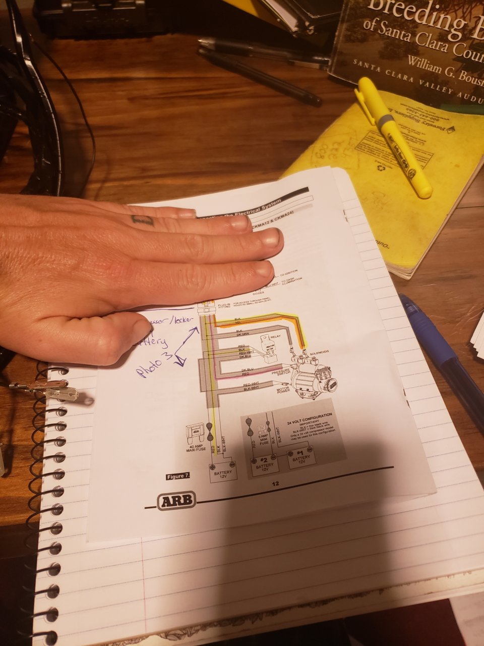

    Okay, so my original plan would work right? The only part not used is the front locker wires to solenoid.

    you also do not need the blue white wire either since you said you already have ilumination covered

    yes just be sure to tape off the junction that would have gone to the front locker switch, because when the rear is engaged that wire will also be getting 12v and you dont want it to short out against anything

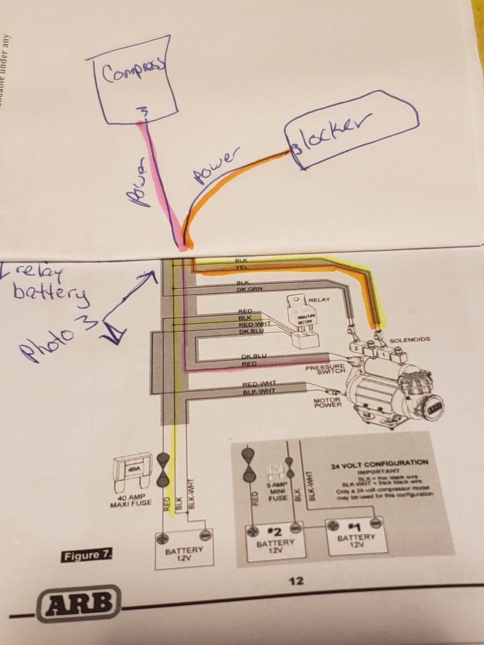

    I am completely ditching this entire part
    The top half of the schematic 15877120244075108492567480623119.jpg 15877120530151172895864118523182.jpg

    That part is gone.

    yes, so all you need is the connector to have 2 connections.
    assuming the GROUND, IGNITION, and ILLUMINATION are already up in the switch panel

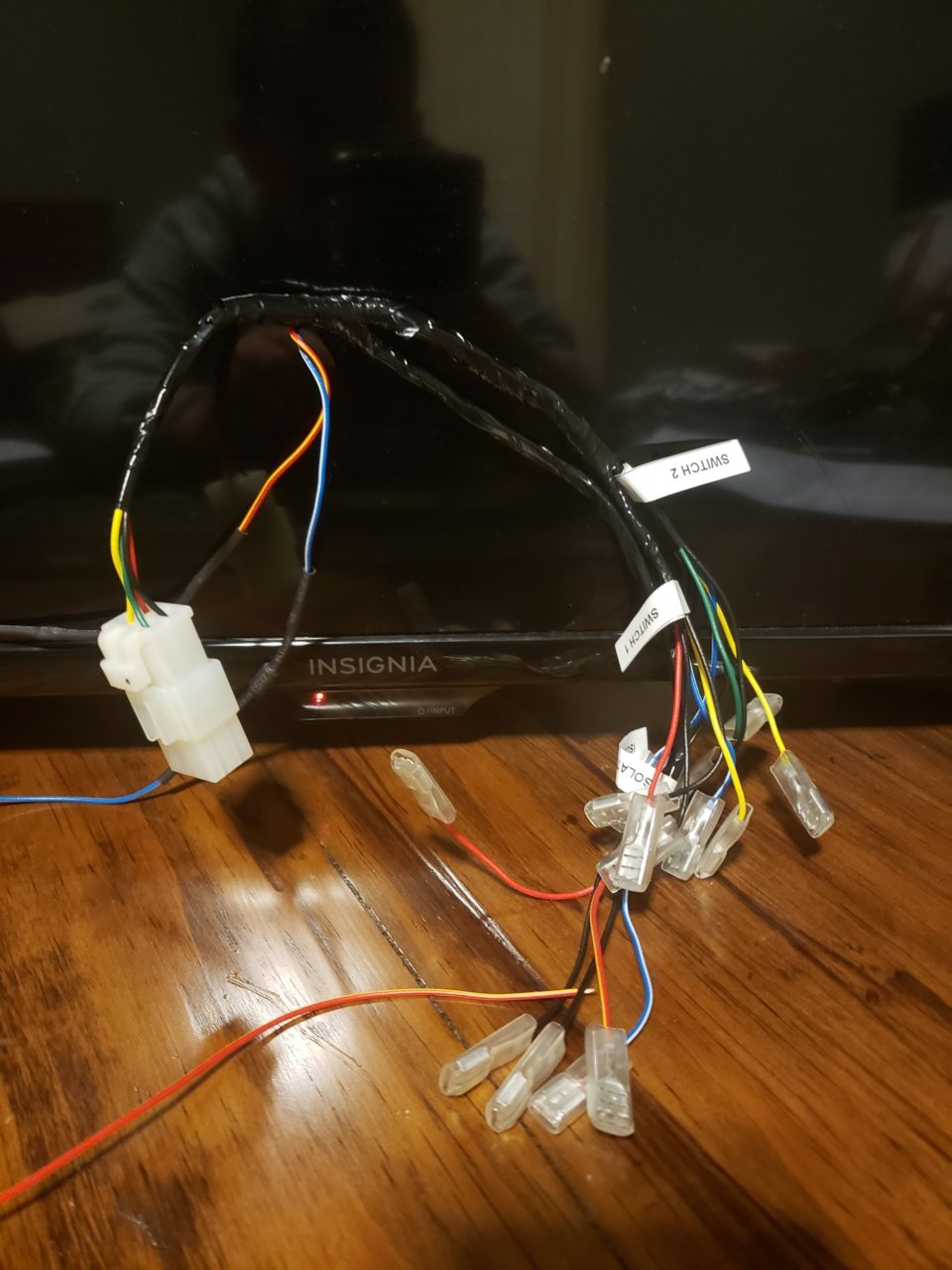

    Yeah that all in the switch panel.

    rushed job. This diagram shows just the wires you need assuming the other 3 are present in your panel already

    you just want that compressor power to also give power to the locker switch
