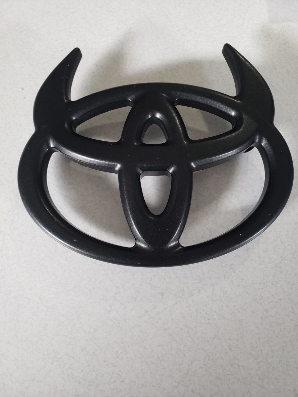

    Hey check out what @FishnTx sent me :bananadance:
