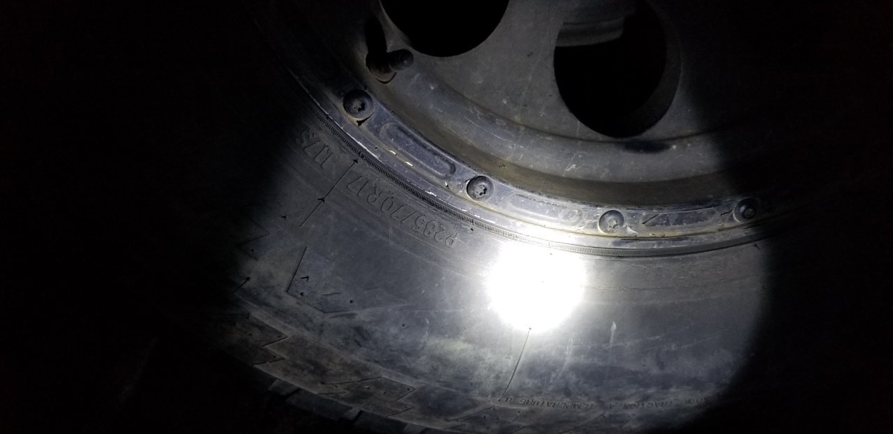

    Would your tires fit without the lift?
  13. May 22, 2020 at 12:34 AM
    Acstaples88
    Acstaples88 New Member
    May 17, 2020
    #328332
    Aaron
    2003 tacoma Trd. 3.4 by. 4x4
    K&N cold air intake
    Maybe. But it would be tight. Il go take a picture

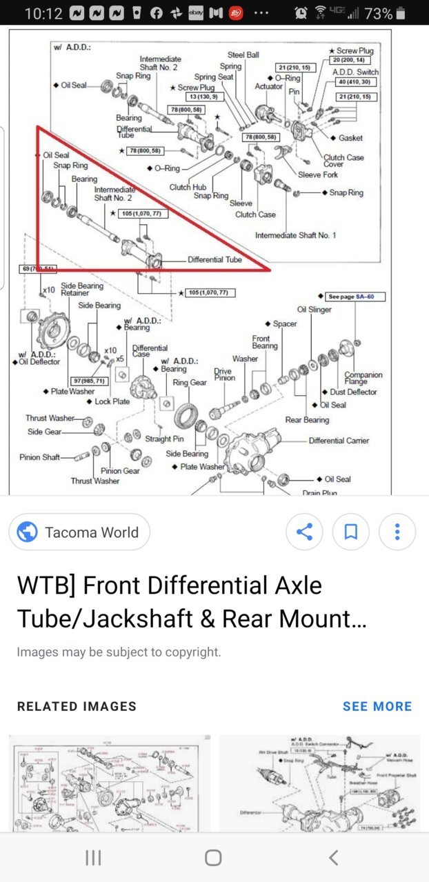

    @Acstaples88 I'm not educated enough on the internals, but the ring and pinion gears dont move in 2wd. I picture the axles spinning in the needle bearings, but I'm not sure something else doesnt move past that.
    OneGiraffe and Acstaples88 like this.
  15. May 22, 2020 at 12:35 AM
    Taco-Obsessed
    Dec 23, 2018
    #276756
    7,448
    Look at tire, 285/70, etc..

    Past the needle bearing is the spider gear than rack and pinion. On driver side. But I replaced the needle bearing for the bushing

    That is the tire size

    285/70/17 so 33s
    Bigger tires with lift

    Spiders gears move in 2wd?
