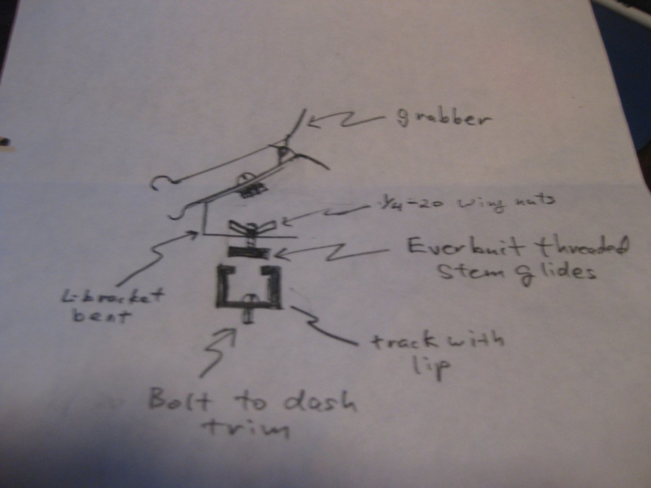

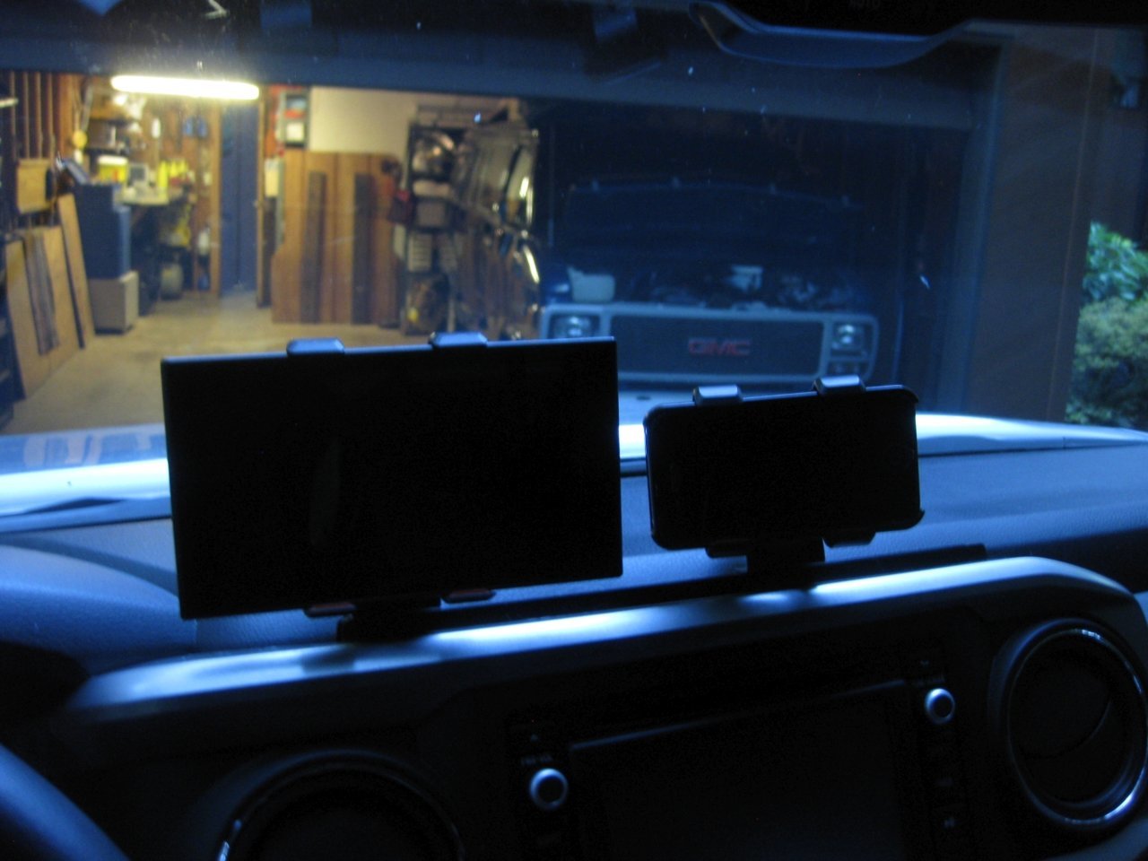

    Here is a DIY. Came out pretty well. Suitably flexible but not ugly when not in use. I made sure mounted devices do not block any view of road. They don't
    intrude above hood line. larger displays might run into a problem there.
    I used a standard from a cheap shelf system (we've all seen them) which coincidentally had a lip on it that my slides could grab.
    I looked at the standards at home depot and they no longer have that lip...so some creativity to get yourself a track is required.
    Should not be hard to walk around home depot and spy something that will work.
    ...or use someting like this:
    https://www.ebay.com/itm/24-Aluminu...5-16-T-Bolts/151866370377?hash=item235bf0e949

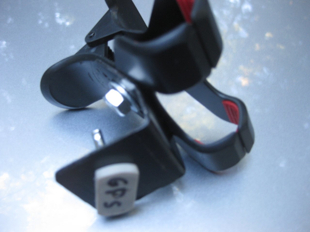

    I ordered a couple of suction mounts from ebay and disassembled to just use the grabber portion. It was a very good mount in its own
    right:
    [SOMETHING FUNNY WITH THIS EBAY LINK...I'LL SNAP PIC AND ADD TO END OF PICS.] It should still be available..or use something else.

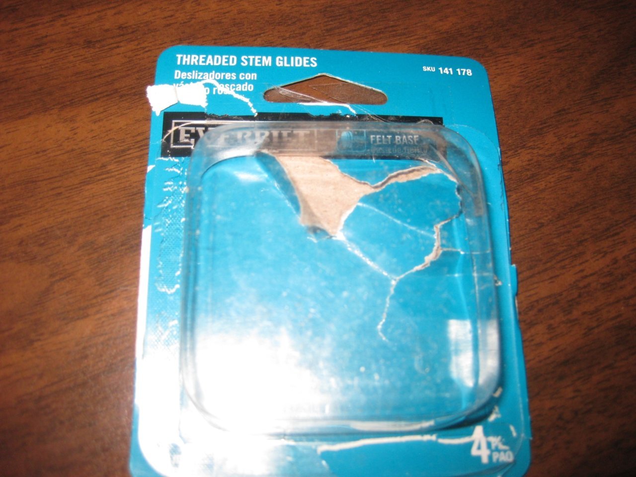

    See pic of the threaded stem glides from home depot that I ground down to create the slides.
    I think the rest is self explanatory...not the greatest pics but they should work.
    I just made 2 brackets (one for gps and one for old iphone i use for wifi display of ODBII gauges). I can make more as needed.
    You can swivel and bend the brackets to get the best angles (like for glare) but it is not completely flexible..mostly though.
    ...and some black spray paint. Put some electrical tape on the bottom of the bracket
    so there is no painted metal on painted metal contact when sliding into position.
    Overall cost was under $20 i think...the most going toward buying the grippers.
    Major Tools I used were a drill press, grinding wheel and vice (for bending bracket) but you'd get away with a hand drill and belt sander.
    hth...phil
    ps. what appears to be scratches is actually cat hair. i have a feline helper buddy.

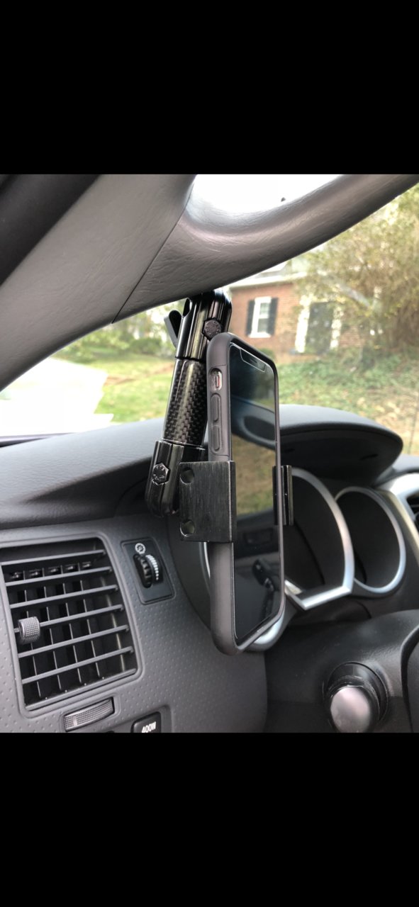

    Bolt that runs into the a-pillar Mount.
    Zion[QUOTED] likes this.

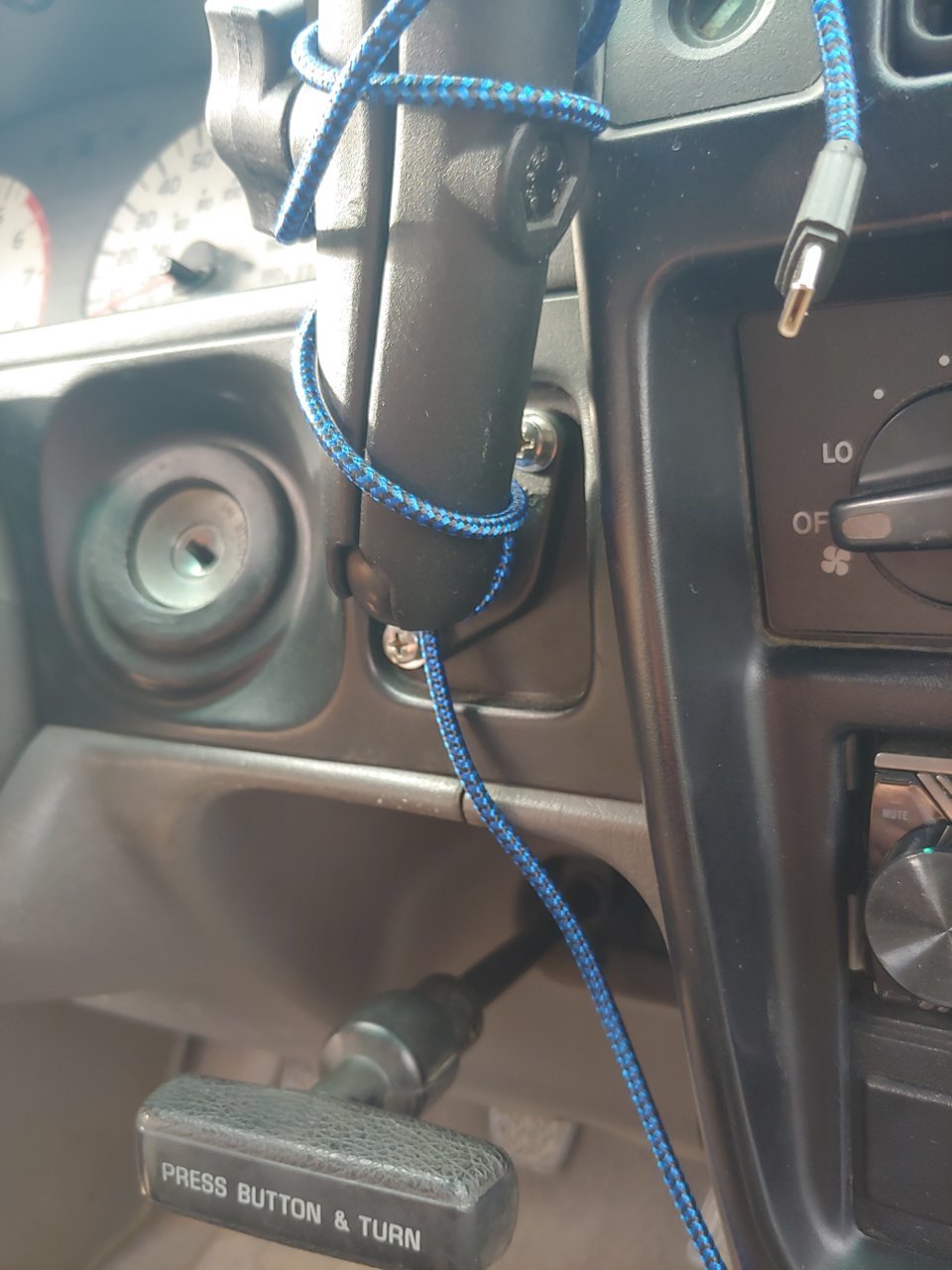

    I'll second the mob armor. I found them when I was looking for a cell phone holder on my motorcycle. Very sturdy holder and mount options. I've used the ram mount and magnet mount, both worked really well. Used on a DRZ400 and DR650, also in my truck.
    They're expensive, but magnets would always drop my phone if I ever left the pavement. Mob armor hasn't let me down over some gnarly terrain.
    The clock bezel worked well for me as a mounting spot, space is pretty limited in the 1st gens. Picked up a clock delete bezel off ebay and it fit a Ram mount perfect.
    As a bonus, if you're in CO and get stuck on I-70 it can flip sideways and you've got a great way to watch movies...
