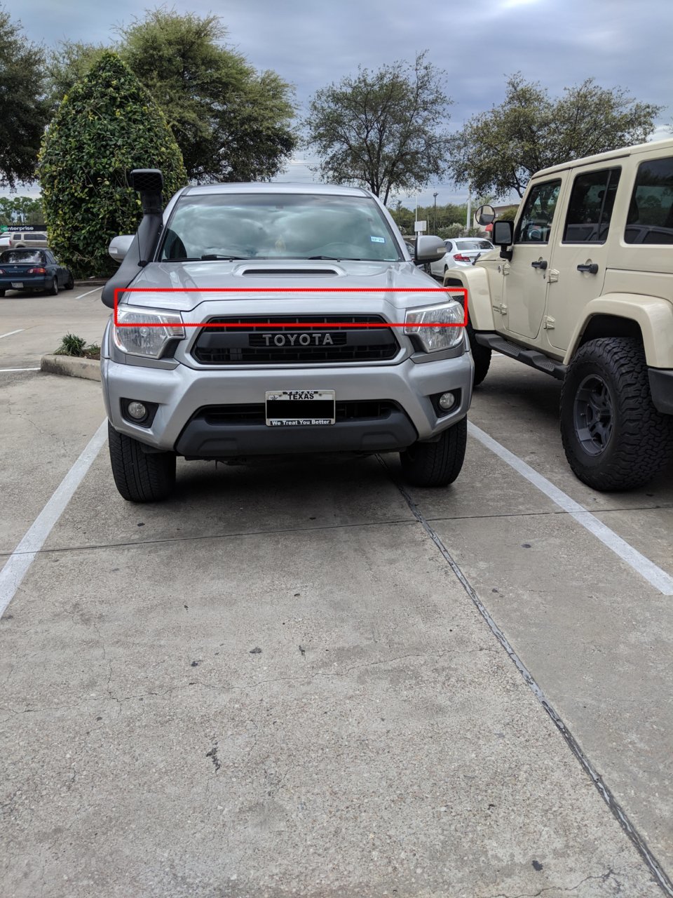

    Hey guys.
    Recently bought this truck, and I noticed something off about it. Wondering if this is a common problem, and possibly an easy fix? The hood of my truck from the driver side to the passenger side increases. I've clouded it in the photo. Anyone know what could be causing it? I've looked under the hood to see maybe if something is obstructing it, but couldnt find any.. Any advice would help.
    Thanks!

    Probably a cheap/knockoff aftermarket grill, doesn't line up properly

    I agree with @eon_blue, looks like the grill. The factory grill on my Tacoma wasn't perfect either.

    Do the fenders line up with the hood properly? If so, it's the grill. If the fenders do not line up properly, and it's therefore the hood that is off, adjust the rubber bumpstops.

    I would just get a new grill from a reputable vendor if you want an aftermarket one. The cheap Chinese ones tend to do this

    It's not the grille...if you zoom in to the drivers side, you can see the lip of the fender is above the hood-line.
    As others have said...adjust the rubber stop on the drivers side of the hood to raise it up.

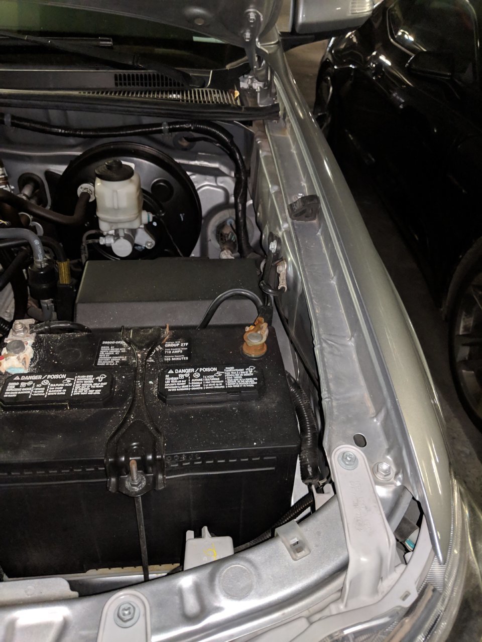

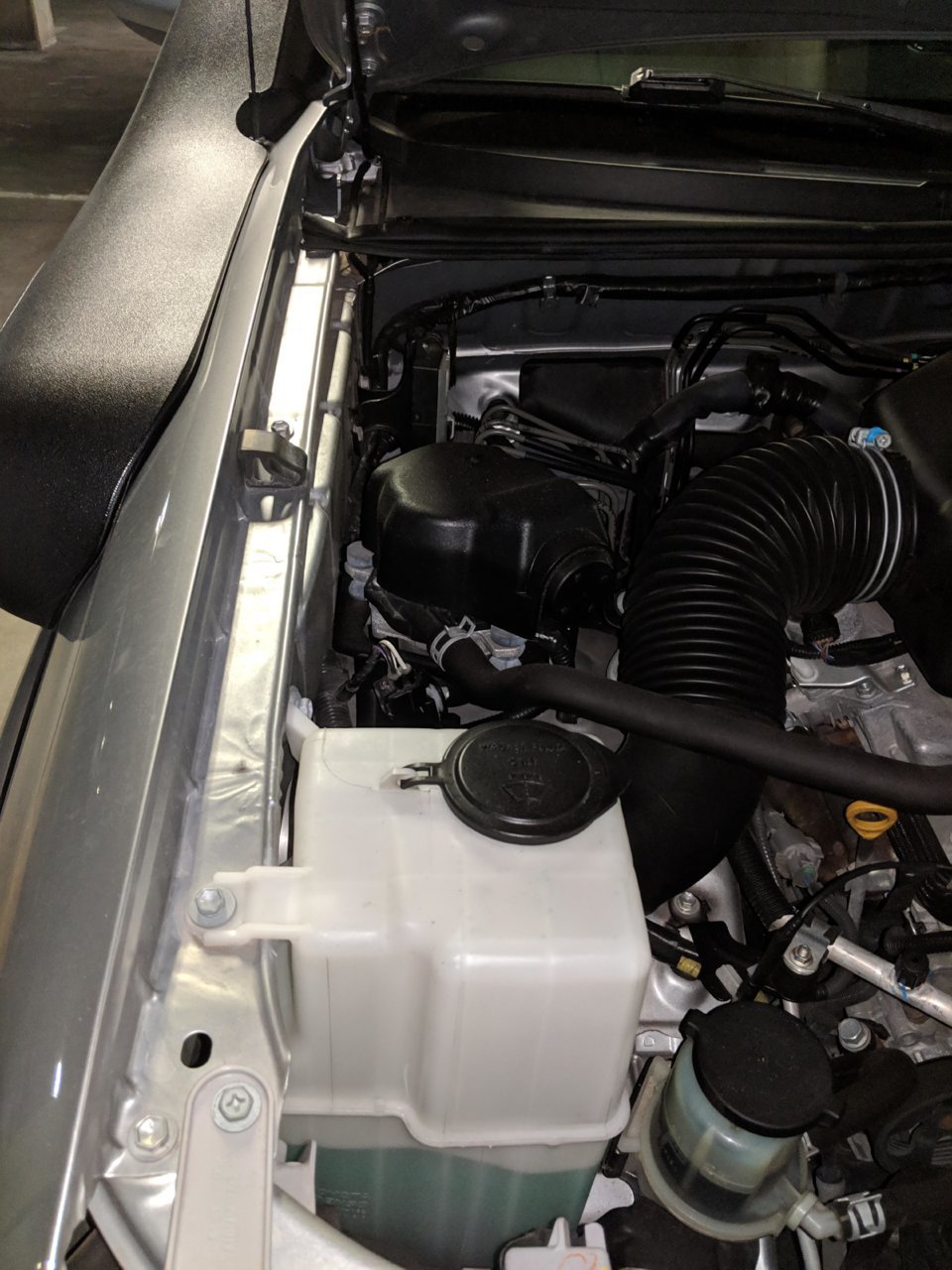

    I'm sorry, but can you clarify on the rubber thing?
  20. Mar 15, 2019 at 12:44 PM
    #20
    TacomaMike37
    TacomaMike37 Well-Known Member
    Aug 12, 2013
    #110316
    5,077
    13' DCLB MGM
    On the third pic you posted. See that black piece. That is what the hood sits on. See if you can that, but on the right side. Does it twist?
