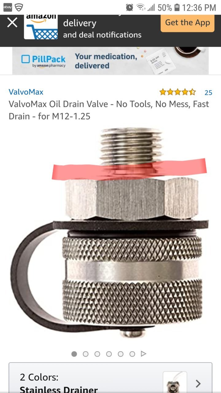

What's everyone's take on the 'easy' oil drain plug solutions?

    This is our story Owner thought it would be a great idea for our Fleet of diesel Tow Behind welders. speed up oil changes .
    Might have worked fine if they lived in Texas or Arizona .
    Salt and Liquid brine corroded things so bad next oil change the whole valve needed to come out to drain the oil
    If you don`t have winter or winter is 55 degrees

    Spend the money on a 1/4" torque wrench, if you're that worried about drain plug hole wear, instead of adding the quick drain valve. IMO just one more thing to fail.

    Zip tied a tube to my Fumoto and drain right into an empty milk jug. ZERO mess and zero leaks. I just tuck the tube up into the hole in my skid plate when done. Easy peasy.
    The messy part is replacing the oil filter.

    I have the Fumoto on a couple vehicles and like it, on my 2012 it's tucked up nice enough to be out of harm's way for the most part.
    I do wonder about the small bit of oil you can't get out as was previously mentioned, but being able to drain it right into a jug is a huge plus.
    The filter is still the messy part, but if you put an empty loaf bread wrapper on your arm before letting it drop, you can peel it off with the oily filter inside.
    I would not put the Fumoto valve or similar on a drain plug that comes straight out the bottom of the pan like a Cummins Dodge.

    Never really thought of how much it protrudes into the oil pan! Having said that, I'm not too worried. Who's going to be the first one to drop their oil pan and and actually measure and take a picture?!?

    I would be glad to if some one donates a valve.
    If I did not throw the oil pan away

    Ran a Fumoto on my old 09' Taco and my current 16' 4Runner Trail. Love them, but I use the safety ring that snaps in place to prevent it from pressing and turning the drain lever.

    Not to revive an old thread, but why not just cut down the portion of the threads that extend into the pan? Just measure the thickness of the bung where the stock bolt goes and chop the valve threads down to that length. I mean if those threads are freeballin' into the ether they're not involved in the thread interface and therefore can be yeet'd away. Thread a nut on it, cut it, back the nut off and dress up the threads done.

    I have Fumoto valves on my Tacoma and Subaru Forester. Oil changes are much easier because I can drain directly into the waste container. I'd recommend only if you change your own oil. I can only imagine what would happen if you left it to an "oil change specialist" to figure out

    Yeah dealer doesn’t touch my car. I think if it were easier to change my oil I’d be more inclined to do it more frequently. Even a cadence of 5000 miles oil and 10,000 oil+filter would really be enabled by a valve like that. Being able to route a hose into a bottle sounds ultra low drama.

    Yep.
    Old Routine:
    1) Place pan under drain plug
    2) Unscrew plug
    3) Wipe hands from oil that sprayed, clean up oil that missed the pan.
    4) Retrieve plug from bottom of pan. Wipe clean
    5) Once fully drained, pull full pan from under truck
    6) Clean up oil that sloshed out from step 5
    7) Pour oil from pan through funnel into waste container.
    8) Clean up oil that spilled from over-filling waste container.
    9) Clean funnel and pan as well as any stray drips.
    10) Replace filter and refill oil
    New Routine:
    1) Connect tubing to Fumoto valve, place end into waste container
    2) Open valve to drain into container. Close when full.
    3) Change container then repeat step 2.
    4) When fully drained, close valve and wipe clean.
    5) Replace filter and refill oil
  18. Jul 27, 2024 at 7:15 AM

    I picked up one of these, which eliminates steps 3 & 4 from your first list, for those of us who subscribe to using the oem drain plug:

    I use the No-Spill drain. Love it. Especially when I got full skids. And only a 3" dia hole. Just unscrew the cap and screw on the hose. Easy. I did have a Fumoto valve, that worked great, Until it didn't. I'm big fan of the no-spill system. Plus it's not hanging down like the Fumoto
