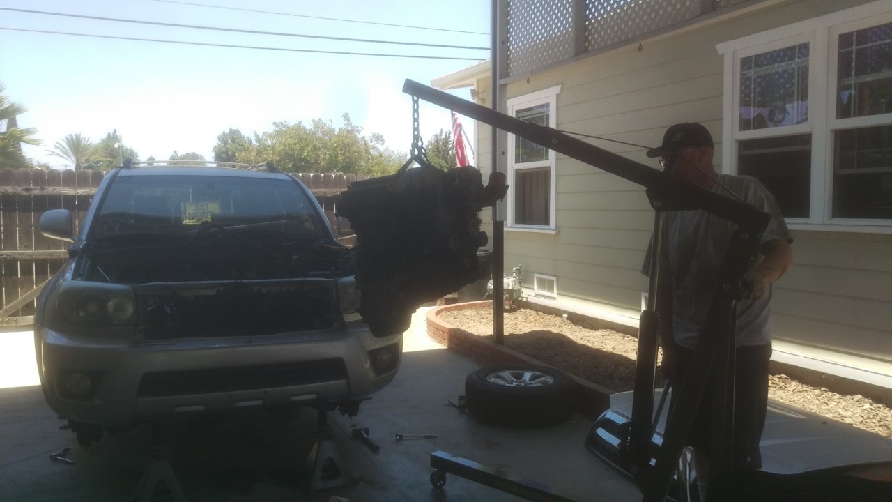

    Easier to do the head gasket with the motor out of the truck... if you're pulling it why not just put a used one in. That's what happened with my 06 4runner. Came up on it because of a blown head gasket so I just swapped it for a 08 4.0 with 62k on it. IMAG1843.jpg

    No doubt, that would make overall access easier. If I were to go this route, I'd strongly consider a cylinder hone( bore if needed), rings, oil pump; new bearings, but maybe a rebuilt Jasper or equivalent would in the end be the cheaper than an owner rebuild.
    I know a lot of people say drop in a used engine, but do you know with absolute certainty the condition it's in?

    Not worth the machining... the motor got so hot they melted the knock sensors in the valley between the heads. Traded a 95 explorer for it and put in a $2000 motor from a year I knew didnt have head gasket issues. Done and done
