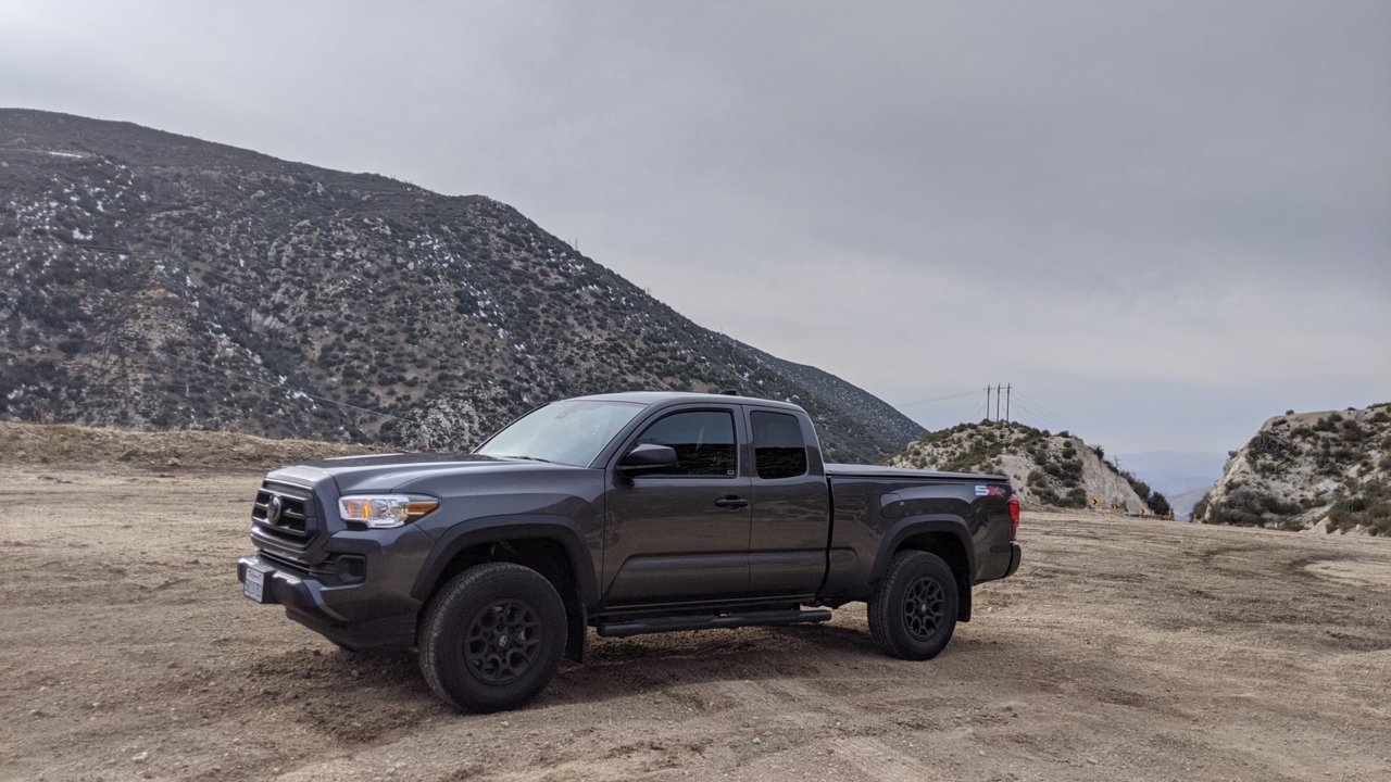

    I have a Base SR 2.7 2WD.
    It sees primarily city/hwy driving but of course i want to be able to take it on fire roads and the like (no major off-roading of course).
    So this begs the question, what do I upgrade first? Ideally. I would replace both at the same time but that means I would have to save up twice as long and I am impatient.
    As far as tires, I'm thinking of going with pizza cutters (Cooper Discoverer) and as far as shocks, I'm thinking the Bilstein 5100 leveling kit unless I can find a set of gently used off-road shocks.
