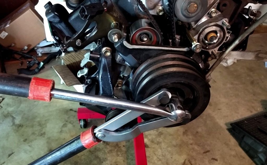

    As promised, some lower cost tool alternatives.
    When I started the project, I had trouble finding the Schley crankshaft tool. Online sellers nor Schley had the tool in stock when I needed it. I'm actually glad they didn't have it in stock. I found a multi-purpose alternative with the OTC 4754 tool.
    OTC Tool -- Now you caught me using cheater bars "black pipe" that I bought a Lowes many years ago.
    URL=https://s286.photobucket.com/user/R...1999/Engine_Work/Crankshaft_Bolt_01.jpg.html]Crankshaft_Bolt_01_8965aff22200f1b7d0273fcd770d1208ca5986fe.jpg[/URL
    How to mod the tool for the crankshaft pulley.
    https://www.tacomaworld.com/threads/timing-belt-project.611161/page-3#post-20735475
    OTC 4754 Universal Pulley Holder Video - The guy in the video is working on his 1st Gen Tacoma.
    https://www.youtube.com/watch?v=j_TfAACwJac

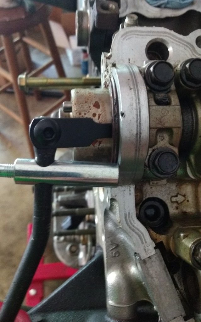

    The Lisle Seal Puller in action. This is the recommended tool for pulling the camshaft seals.
    TB_01_Seal_Puller_f7b6bb1557e4a62fafd512e25c4e0d44b5b3d394.jpg[/URL

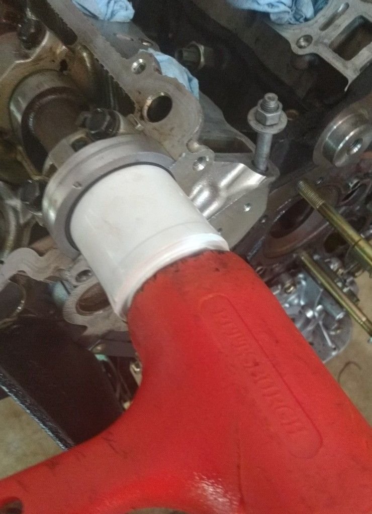

    Freeze the seals before installation. It makes them so much easier to install. I use a little bit of red grease on the metal surface to keep the seal from being pinched during installation. After freezing seals, I had a couple of that I could practically install with my fingers. It’s a game changer.
    TB_04_Red_Grease_203c3124f3ed98340a4698f193ce10fb98b2c28a.jpg[/URL

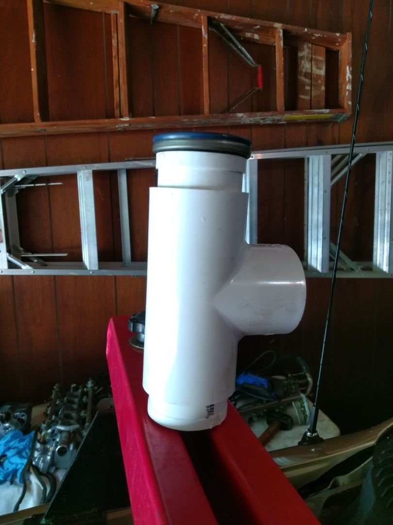

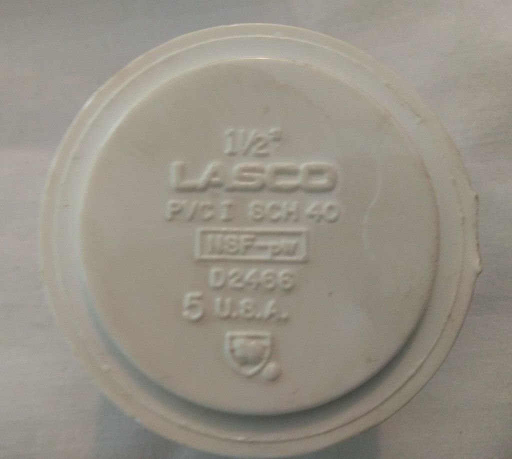

    I used a PVC pipe end cap as the cam seal installation tool. We’re talking a couple of bucks for this tool at Lowes.
    TB_05a_Seals_In_d86ed77f4137014df9a698c846b5902091244267.jpg[/URL
    TB_05b_Seal_Press_42e1d6f9aa13ad8e5b0ba117e083dcfbbbd8db60.jpg[/URL

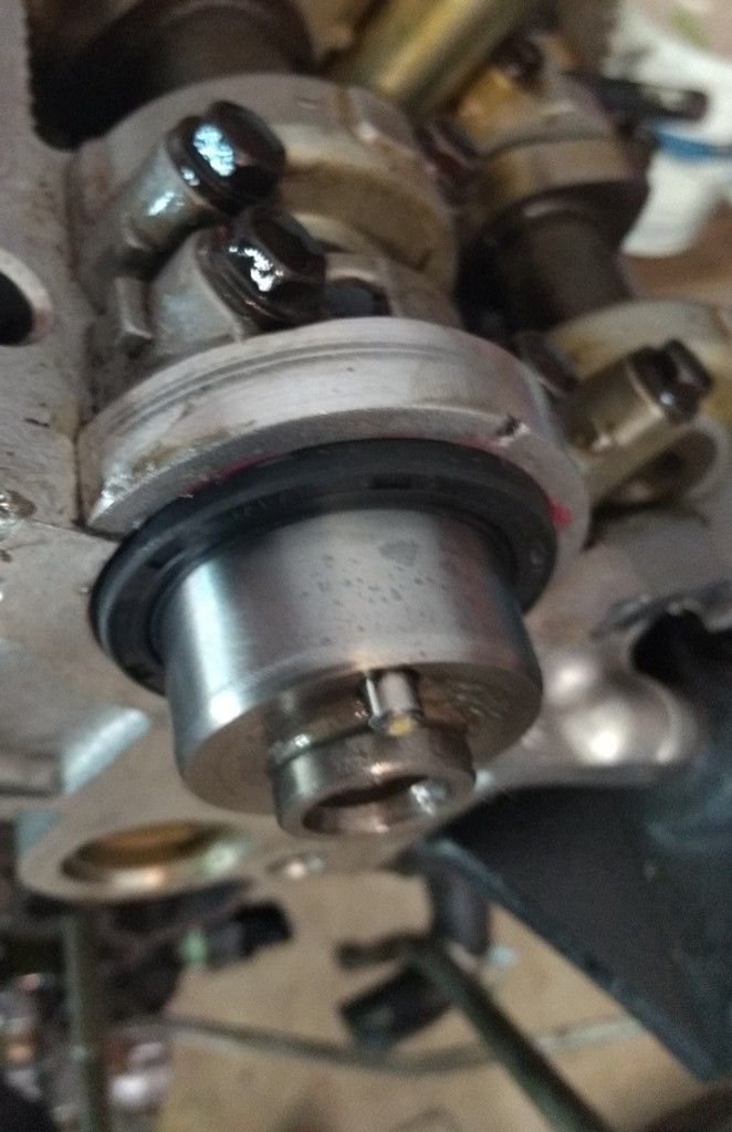

    Seals installed.
    TB_06_Cam_Seals_in_66e7e83e1f492b1a87c215a65f3e106a1e1c240a.jpg[/URL
    The multi-purpose PVC seal installation tool.
    AACJ_04_Trans_Seal_1735f6dec8121b6bfc6b1a2bc035ff0bd982edda.jpg[/URL

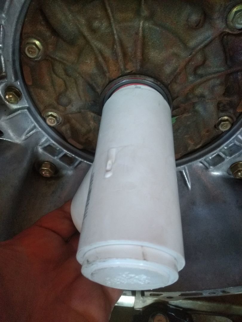

    Used it for installing the transmission and front main seal. It works the same way for both seals.
    AACJ_05_Trans_Seal_74f82eb6ef60653ea000f619100f442d6a5e576c.jpg[/URL
