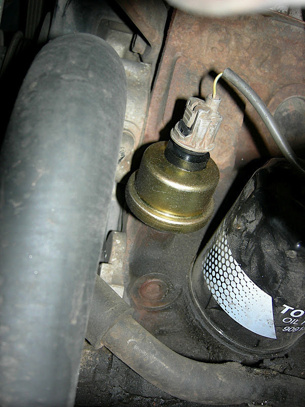

    I was changing my oil and noticed a switch near the oil filter.
    It was totally rusted (Ohio) and the wire had rusted off.
    I'd like to replace it, but I don't know what it is. I thought it
    might be the oil pressure sender, but the diagrams that I have
    seen show the oil pressure sender on the front of the block, not
    on the side near the oil filter.
    2000 Tacoma, 3400 engine.
    Thanks in advance.

    It is the oil pressure switch I venture your oil pressure light never comes on! If the wire is broken
    I have my oil pressure gauge in there .

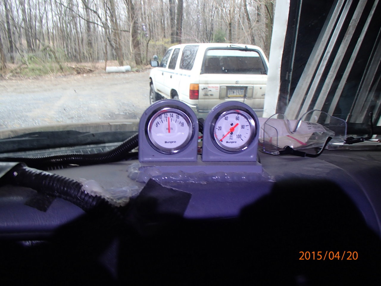

    Wyoming do you have a picture of your setup you can share?

    I will try and remember to take one for you.
    Being I still have the leftover mindset pictures require sending or taken someplace to be developed then printed I just never got in the habit of taking pictures.
    Not real sure just what a picture will show but a fitting ( mechanical gauge ) with a 1/8" copper tube inside a rubber vacuum line for protection towards the front of the engine from the oil filter.

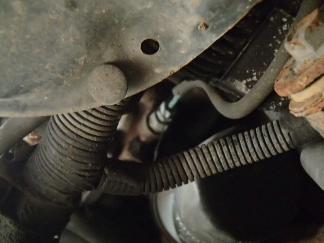

    As you can see fitting and copper line in front of oil filter
    Metric Adapter to pipe thread allowing the use of a compression fitting
    That is the location for the oil pressure switch that turns the light on and off when your002.jpg oil pressure has dropped to the to late now area.
