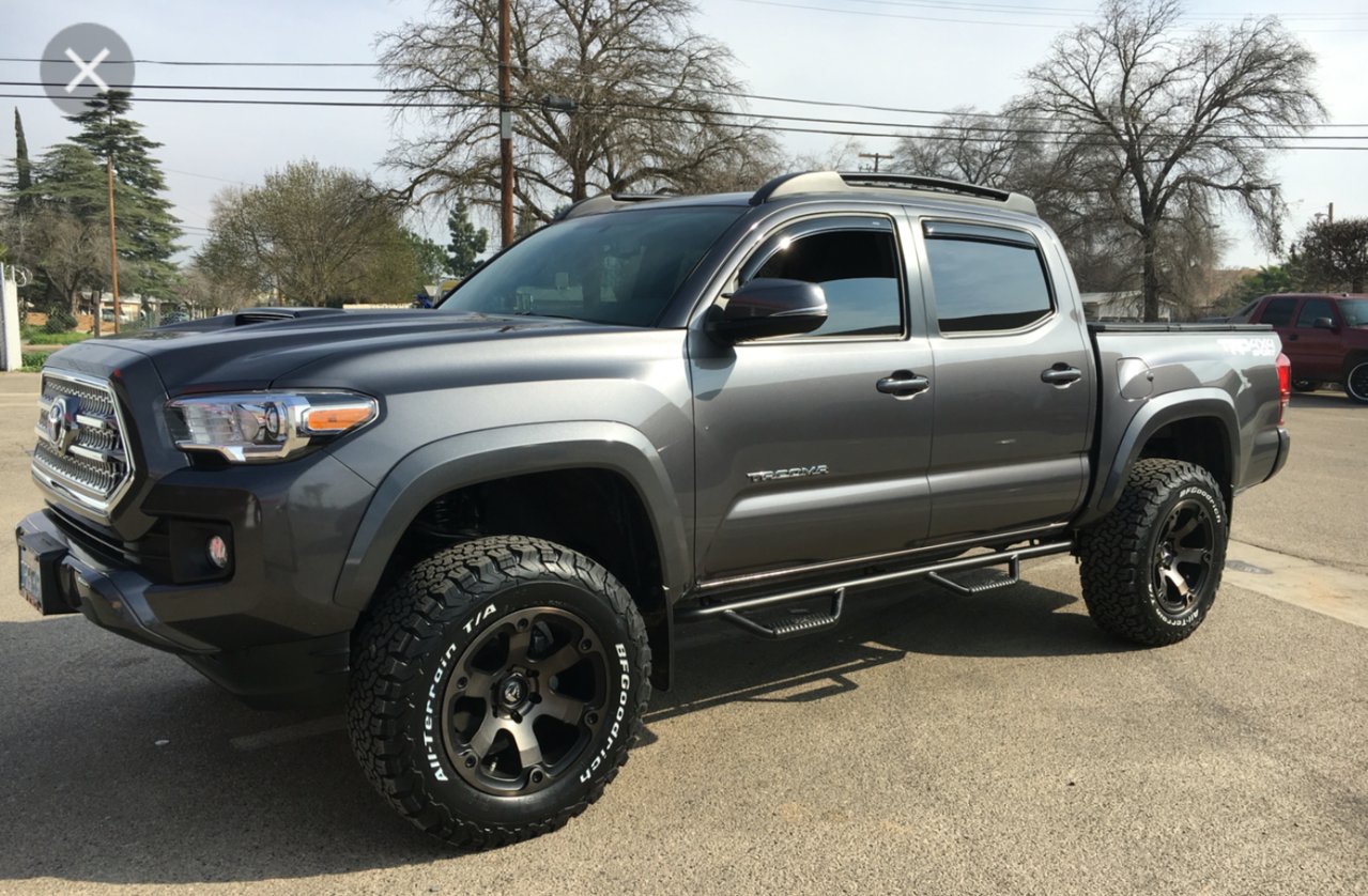

    Anyone have an expert eye that can tell what lift (³” ?) Tire size these are.
    I've got a DCLB MGM arriving Friday and this is pretty much the set up I am hoping to get.
    Love the BFGs in white letters and the wheels (fuel beast I believe).
    Plan on doing a 3" lift and wondered if this is what it would look like on bf goodrich all terrain ko2 265/70/17 or if what's pictured is a larger tire. New to the mod game and can't tell visually.
    I have no frame of reference of what 265/70/17 would look like on the new taco and don't want to purchase blind but I've got a good deal some 265/70/17s.

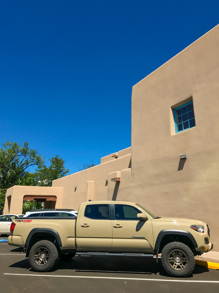

    Tuff Country 3 inch spacer kit with aal Tuff Counrty 1/4" spacer on LF (for taco lean) Bilstein 5160 rear shocks Bilstein 5100 adj front struts (removed tuff country front spacers) set to 0 lift OME 886 coil springs Front sway bar relocation bracket N-Fab Rock Rails 17x9 -12 Fuel Beast wheels Toyo AT2 285/70/17 tires Led light conversion on all interior lights Morimoto 35w HID kit 5500k OE all weather floor mats OE Tonneau cover OE Door Sill Protectors Bed Mat De badged all factory emblems matte black vinyl tailgate letter and Tacoma emblem on door silver vinyl insert on glove box and door sill protectors OME Carrier Bearing Drop Insain Fab cab mount chop plates Weathtech Rain guards
    The Fuel beast wheel look better in the 17x9 -12 offset.. just my bias opinion
