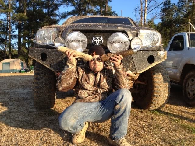

    Hey guys, snapped off both my rear billies wheelin over the weekend and I'm wondering if anyone has any suggestions for stronger ones.

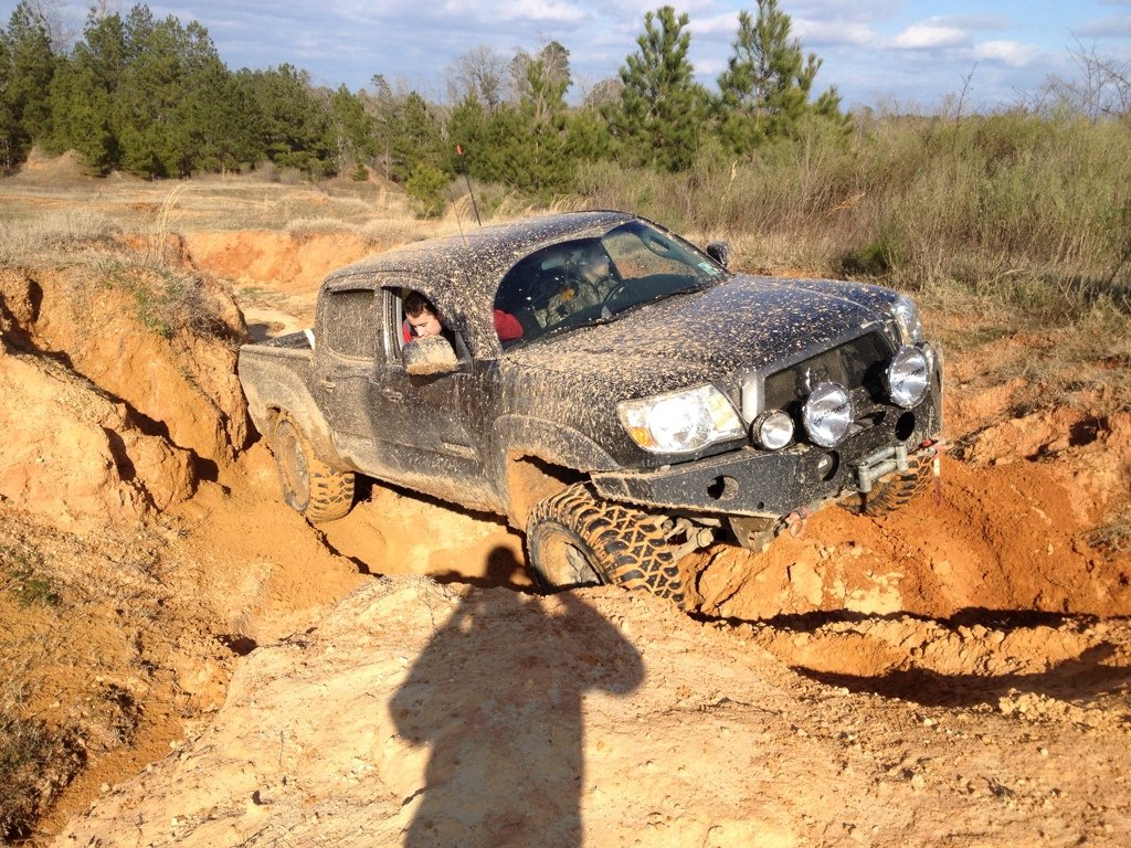

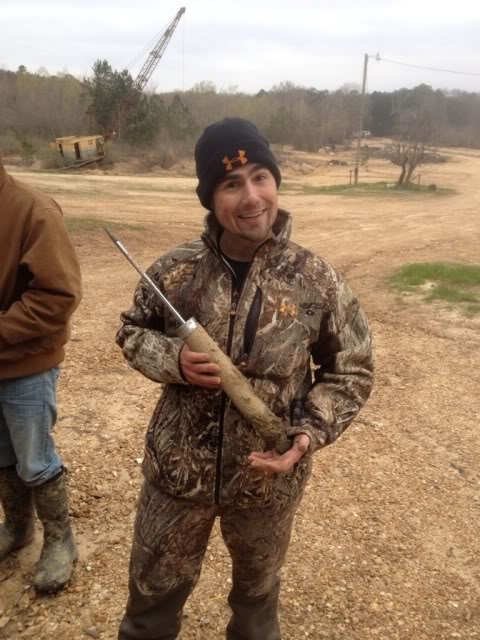

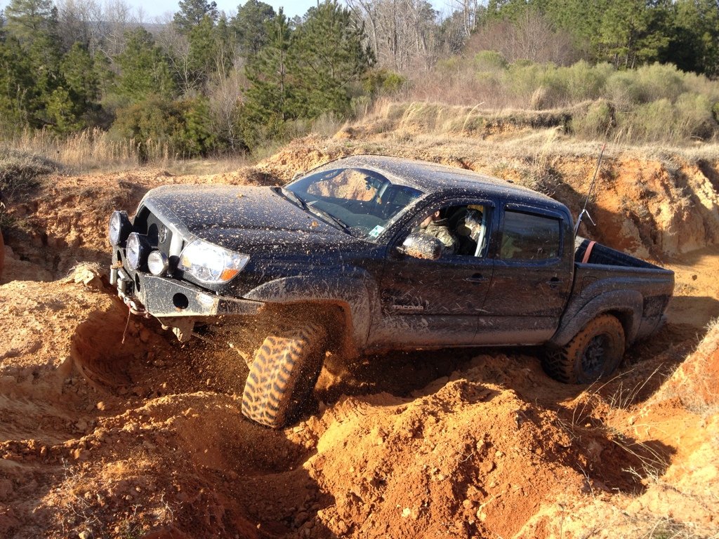

    Just wheeling some washed out areas at an offroad park in north louisiana. I snapped one Friday night and the other one Saturday afternoon. They both broke off right at the beginning of the threads.

    One!
    And two!

    Haha nice pics. If they both broke at the spot is there an underlying reason why they're breaking? What's your current rear suspension setup?

    Nah you take a left just after the pit. It looks way too intimidating from the main drag but I followed a rubicon through it no problem Friday night, so we decided to hit it up on Saturday

    Looks no too bad. All dirt so the worst that can happen is gettin' stuck. As long as you have recovery available, go ahead.

    That was my mindset going into it. Just came out that last washout too hot.
