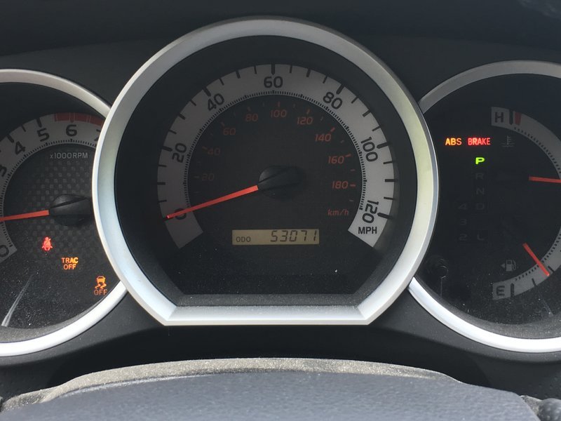

    Good to ask, I have basic understanding of electrical stuff but not a lot of knowledge by any means.
    My switch was a single pole single toggle 2 wire switch, I just ran one end of cut green to one lead on the switch, and then other green cut end to the other lead on the switch.

    Well thats pretty cut and dry, not much to screw up there. Only thing I can think is that your year truck has a different wire used for the abs. Try this. Pull the abs fuse and see what lights come on your dash.

    2012. Hopefully not different. Will try unbolting abs fuse.

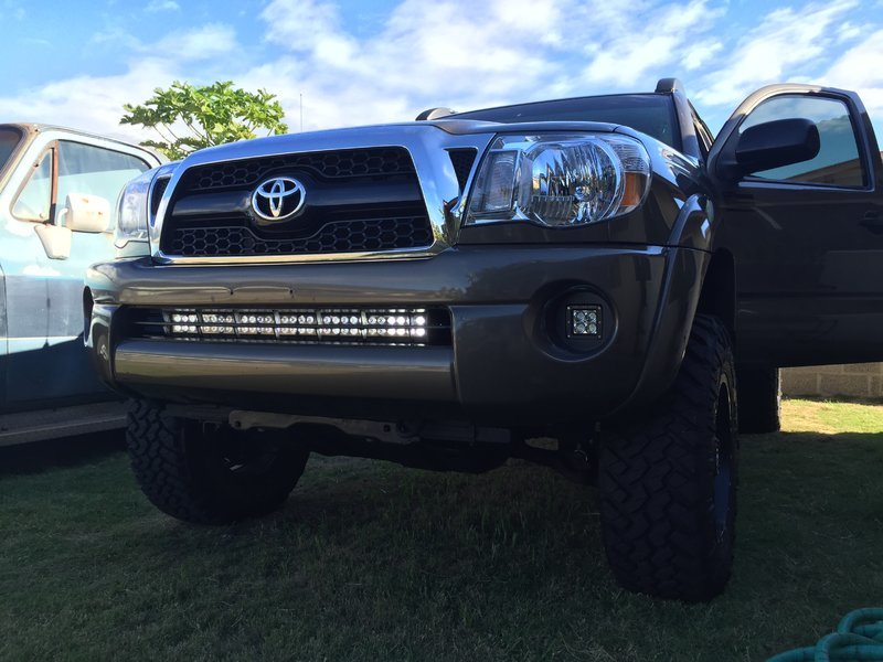

    Yeeeehhhaaaaa their it is!!! 2011 all day!

    put a switch to disconnect the right rear ABS sensor. I promise it will kill all ABS, VSC, etc . I learned that the hard way by breaking it once when I was using tire chains in mud and one broke loose. :) ABS, everything was disabled, even speedometer was like a pinball needle bouncing around.
