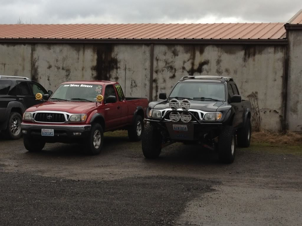

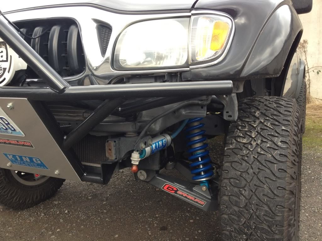

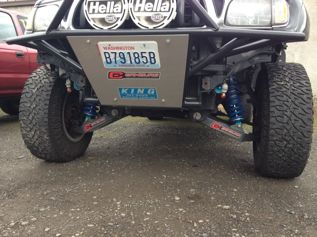

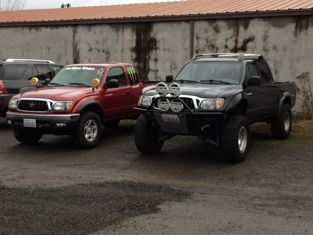

    Im just going to say screw it and go with getting a long travel suspension kit after checking out the new guy at works truck. He has the same truck i have but in a pre runner so i might have to switch things up a little. Im probably just gonna get 33s and get the fiberglass front end conversion cause i want mine to sit like his. mines on the left the red one.

    My main concern was the flexing issue before but the flex on a kit like that was pretty insane
