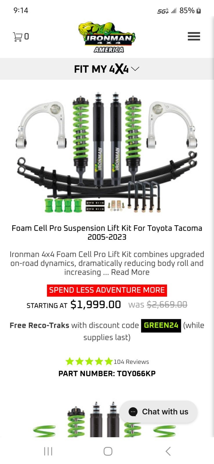

    Go with Ironman Foam Cell Pro lift kit. I have it on my 2013 tacoma Baja and it's awesome. Comes with everything. Front coilovers (adjustable with spanner wrench), swaybar relocation kit, driveshaft carrier bearing drop kit, leafsprings, rear shocks, u bolts, and there's a kit that comes with their upper control arms. I bought the kit without the upc's because I already have SPC's installed.
    https://ironman4x4america.com/lift-kits/foam-cell-pro-kits/?page=2
    They are including free reco tracks with purchase and discount code. I'm kinda pissed off though, I bought my lift kit March 1st not knowing they were giving free reco traks starting march 9th-24th. Free shipping also.

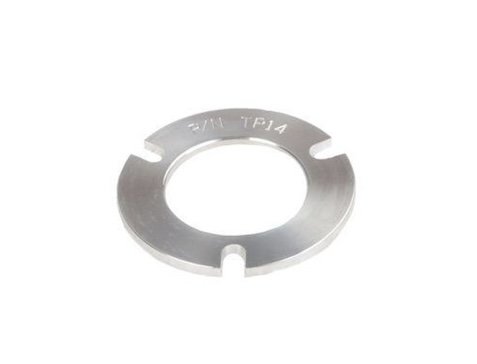

    I did the 5100’s from Toytec, but I went with the 3” front shocks, I love mine and the way it rides! Up front!IMG_2533.jpgand the rest of the kit I addedIMG_3766.jpgi also added the drivers side front spacer to prevent the drivers side front lean that Tacomas are famous for!IMG_3488.jpg
  11. Mar 23, 2024 at 12:50 PM
    TacoTuesday1
    TacoTuesday1 Well-Known Member
    Jun 19, 2019
    #296781
    7,751
    FL
    can’t the left strut simply be adjusted to height, since it’s adjustable height, to compensate for taco lean rather than using the spacer
