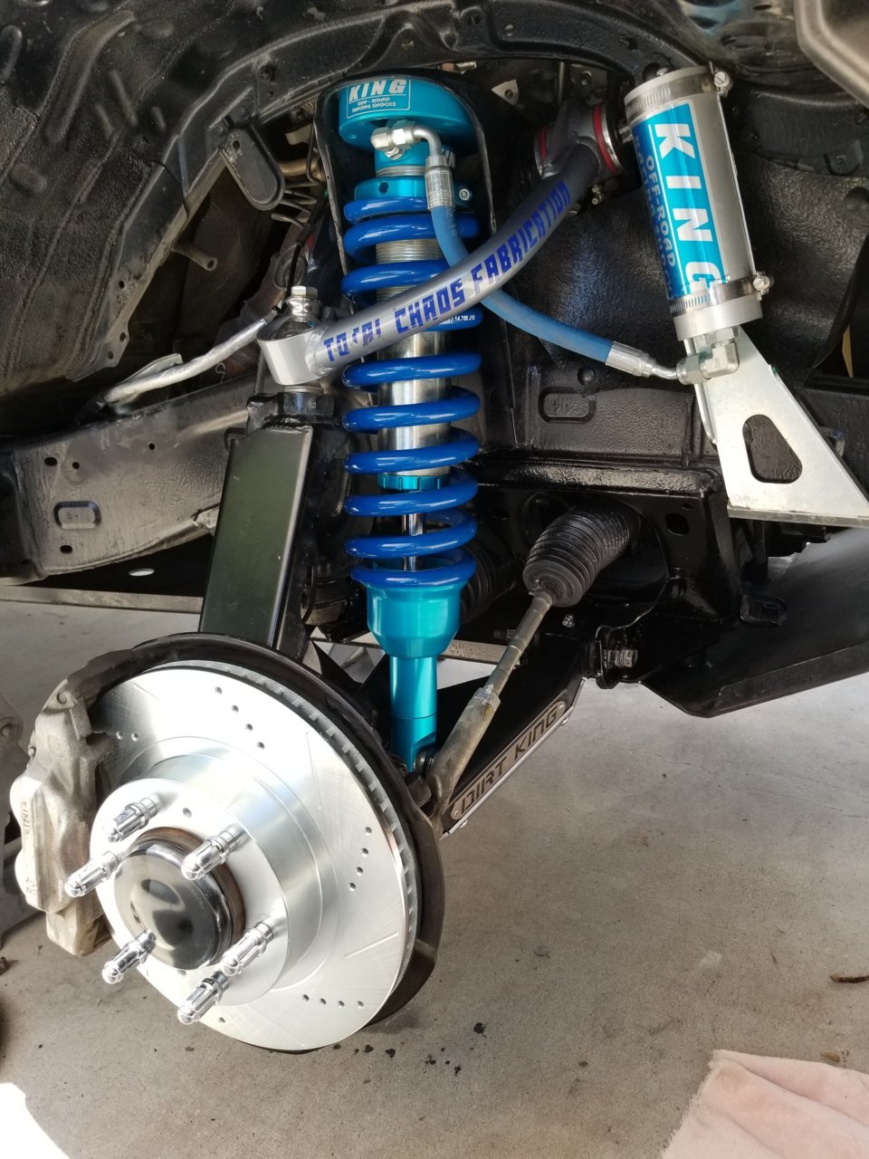

    I have had everything from Stock, FOX, and now KINGS in less then 50K miles. All comes down to how much you want to spend and what are you going to do with your truck.
    I tow an expiditon trailer and wheel in different states, so I wanted something smooth riding and built solid.
    There's alot more to lifting these trucks than just installing a set of coilovers or spacers. Do lots of research before you buy anything.
    Here is my current setup up front. Good luck with your truck.

    Nothing wrong with FOX COs, just decided to do a complete suspension upgrade, had SPC UCA. Went with TC Uniball because I welded on a set of TC spindle gussets. Got DK LCAs because there was a Groupbuy going on and have DK UCAs on order. When Marlin Crawler releases there suspension setup, I plan on moving forward with there RCLT kit.
    I am also on my 3rd suspension setup for the rear. 3" lift, KINGS, airbags, BAMF hangers with a custom x-brace. Good luck with your truck.
