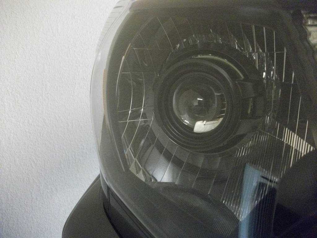

    I have apollo just because i wanted to avoid trimming, IMO, they are the best looking shrouds next to gats

    I've got the Apollos as well, just had to do a little nipping on the bottom for the 1st gen housing

    Apollos here as well.

    I started with the panamera's just because I liked the way they looked. They required a TON of cutting, which I promptly screwed up. Fast forward and I now have apollo's which just fit right on without any problems.
