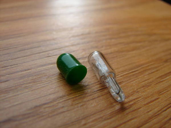

    I want to do mine so bad!!!!! Why was it so hard to install the ones in the climate control panel?

    After you disassemble the whole dash, you then have to take out the white "box". That is the A/C Control panel. You have to take out the 4-5 gold screws on the back of it to open it up to access the lights. Make sure you don't undo the strip that runs the whole panel. Turn the red light holders and then pull them out. Then you've got to unwrap the wire, but make sure you remember how it was wrapped, because you'll need to know when you install the led's later. Take the bulbs out, put the led's in, and wrap the led wires around the red base, and then reassemble.

    Ok mine is a little bit different since I have a 2000 model. The bulbs just push in, instead of a twist in style that was shown in the link. Ill upload a pic of what the bulb looks like.

    02 T4R 4wd
    This is what mine are like. All I could tell on the bulb is there were s14v on it.

    Wow!!! Im sure there is a bulb that fits out there somewhere. But just done a search on google and it seems like this is a bulb from hell!! No one seems to be able to find the exact one that fits just right. There is like three or four different style bulbs that people say it could be. But if and when I find the ones that will fit I will definitely be changing them all to led's.
