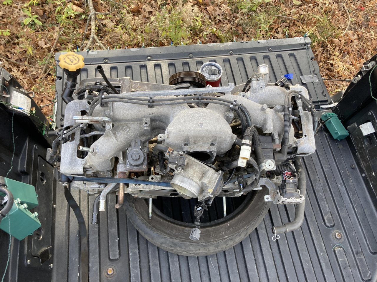

    If it is an Interference Engine and the timing belt broke then it probably bent the valves and possibly even damaged the piston too.

    The radiator was melted!

    Sounds like it seriously overheated, kinda curious to hear what her Son finds when he tears it down.

    probably head gasket.

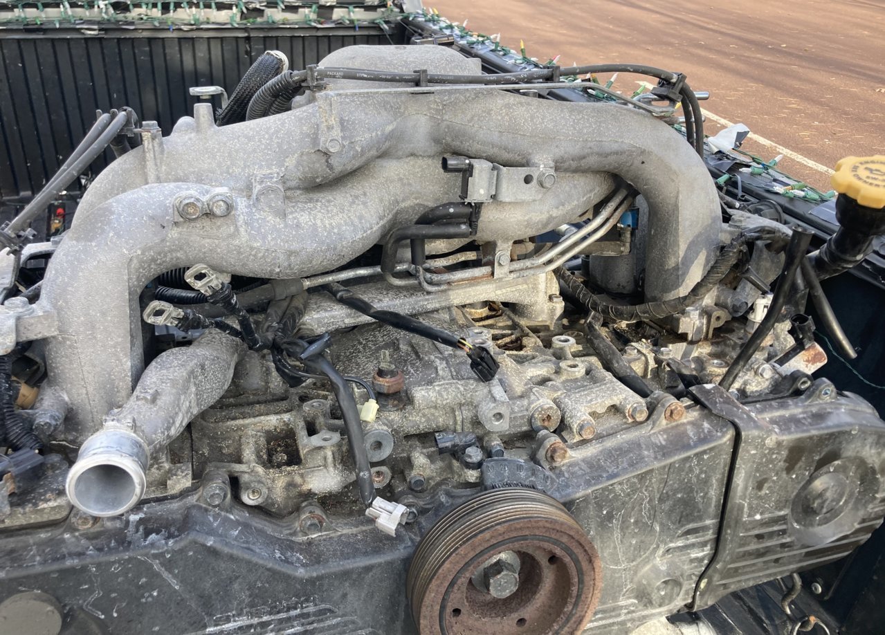

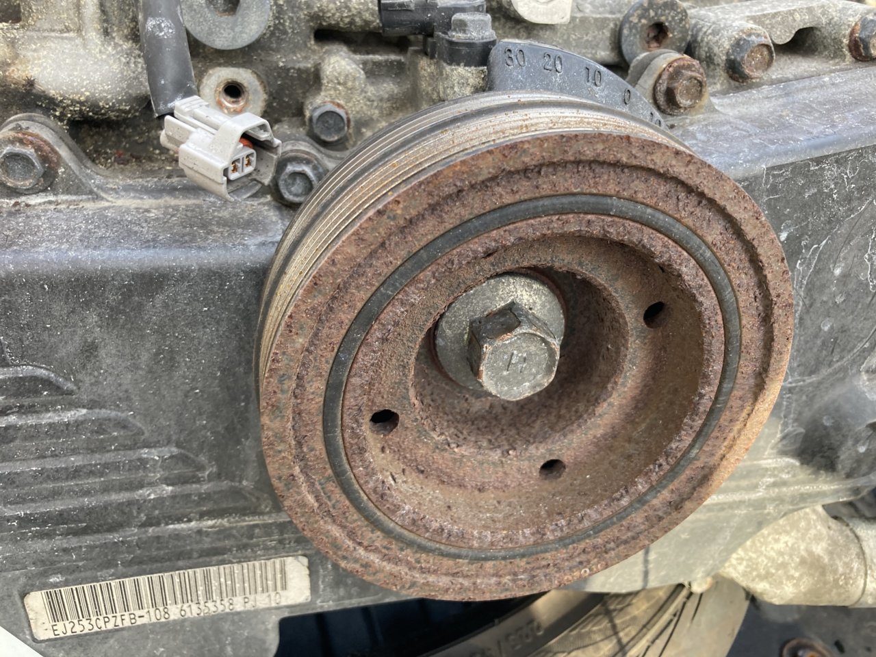

    We are 99% sure it's the head gasket; At Gwyn's house after we got the engine out of my bed, it started hemorrhaging a brownish green mixture which is more than likely coolant mixed with oil, which couldn't be anything but a blown head gasket. The engine is totally seized, with absolutely no play whatsoever in this pulley; The fact that this thing is so rusted is also incredibly suspect...

    I thought Subaru was supposed to be reliable, but apparently this specific era of the Boxer engine was known for head gasket and timing belt failures...?!?!

    This car has a clean title, but the more I look at this engine, the more I think there might have been some water damage...
