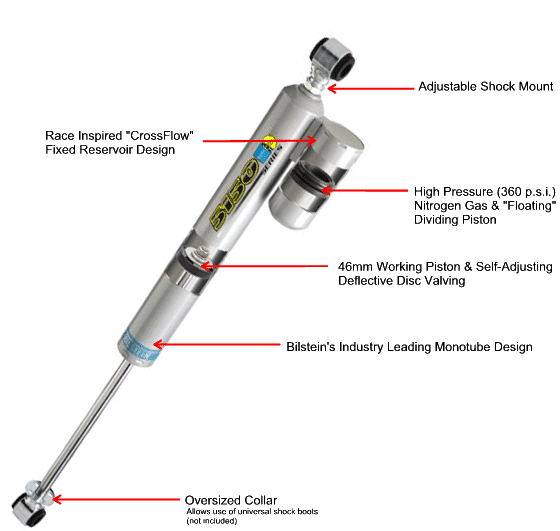

    the 5150 has a resi
    5125s come in "custom" travel lengths
    5100 adj. are for front only

    this is a 5150

    5100s are manufactured to fit stock/lifted trucks and they already have specific shocks for different setups etc
    with the 5125 and 5150 you better know how long of a shock you need and what travel length you want
