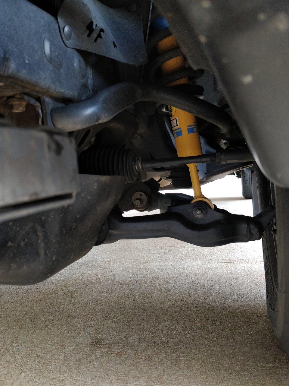

    Okay now I have something to go off of, it looks like she's sitting at about 19 unloaded. How close is the bump stop supposed to be to the wishbone? It seems incredibly low but maybe that's just me?

    The bump stop doesn’t look bad to me. I have the wheelers super bumps on mine and they’re super close. But they’re bigger bumps too.
    If you want to keep it relatively stock, you can always buy a set of bilstein 5100 shocks, set the clip on the first notch which will raise your front end about an inch. You can reuse the stock springs.

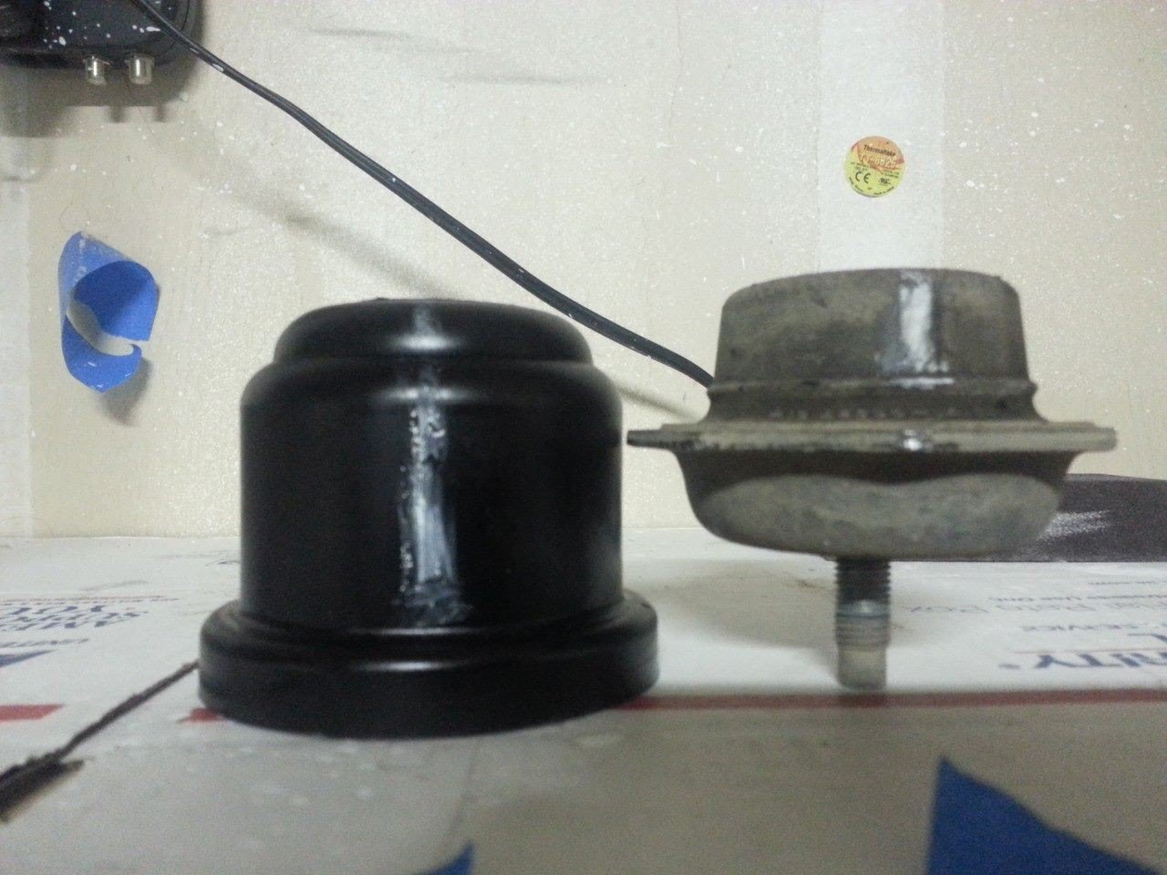

    Superbumps are much taller than stock and offer progressive stiffening as they are compressed. Stock bumps are rock hard.
    Stock vs superbumps
