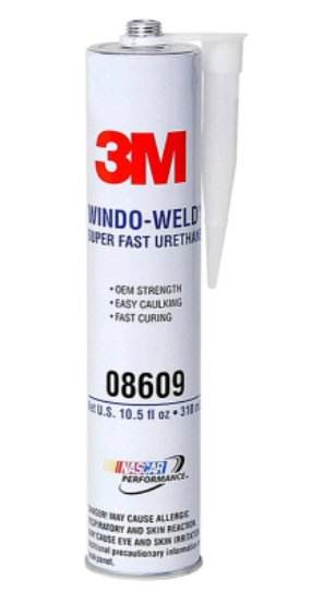

    3m Window Weld. I had a pin hole leak on my lower ball joint boot and dabbed this stuff on it. No grease in sight. Make sure you clean the area real good before using it and dont get it on your hands.

    Yo. Thanks a lot for that info. If you used it on a ball joint, certainly should be tough enuff for the axle boot.

    @steveo27 : May I ask what a cab boot is? And has the black RTV held up well? Thanks. I have a tube of Black RTV already, or go spend $25 on the Windo-Weld. Windo-Weld would probably take a bit more stress and pressure.
