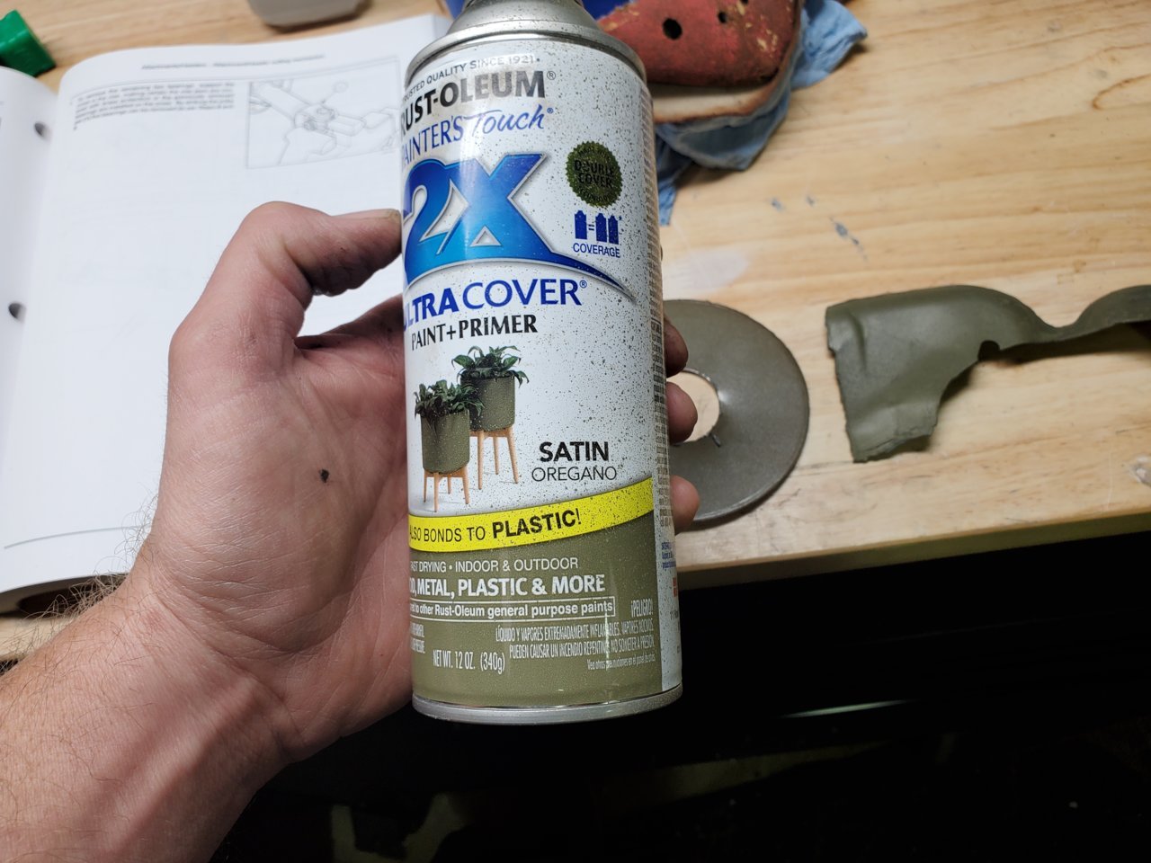

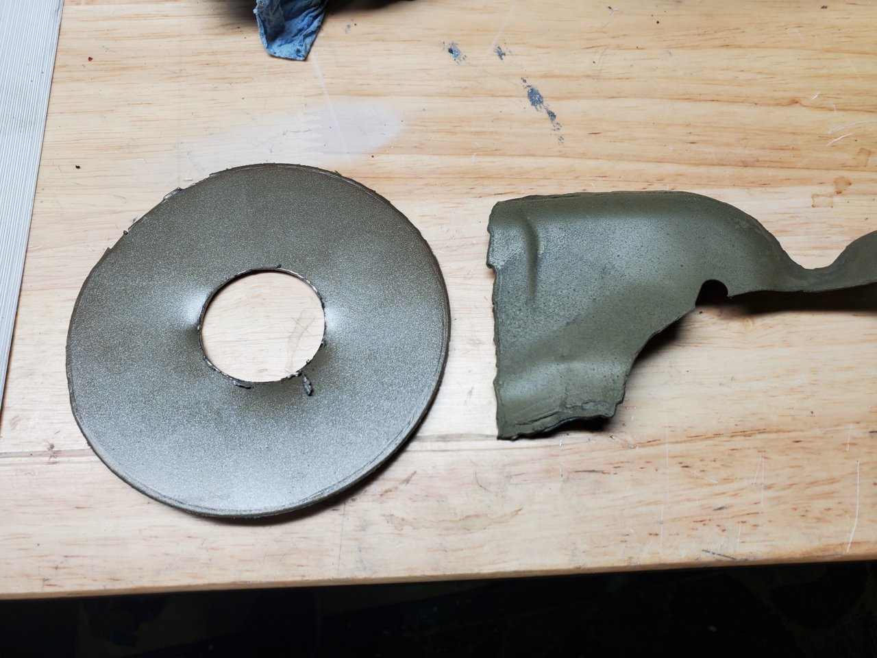

    For the record, in case some poor sap searches "eletrocoating color match" and finds zero info, Rustoleum Satin Oregano is a pretty decent match.
    I know Napa has an automotive paint department but the local Napa absolutely sucks here and they couldn't tell me when their paint guy would be back. There are no other automotive paint stores open here (on Saturday) within an hour's drive so I ended up at our local Ace Hardware. Turns out Rustoleum Satin Oregano is close enough to the electrocoated underbody coating given my constraints today.
    The round cut-out is OEM, the other piece of scrap is the Rustoleum.
