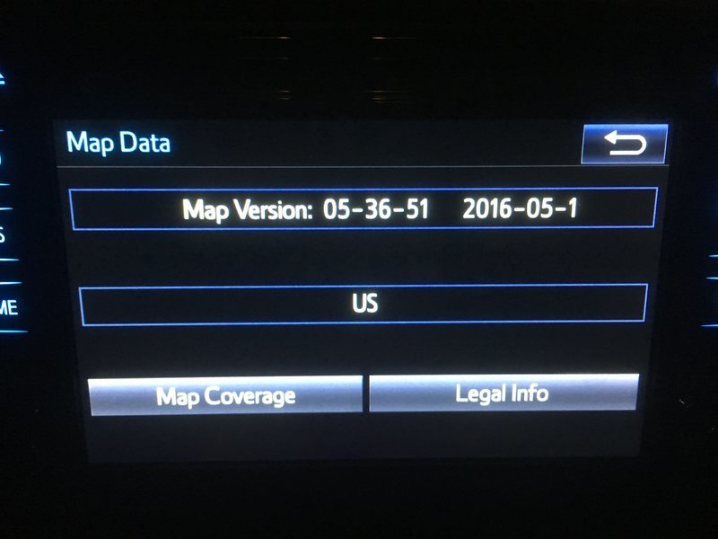

    Just checked mine is 184 on the card itself which is a microSD. Versioning on the Nav shows as pictured. I don't see a sticker or anything special about the card , it is a san disk, but does have "Toyota" painted on it
