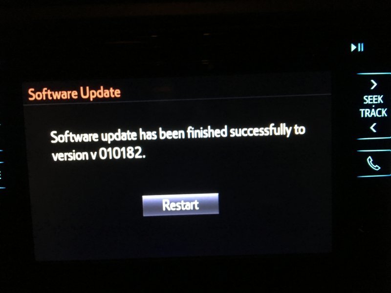

    Wait, it updated, but then it won't read the card??? o_O

    Yea I'm writing the old image back to the disk now. If it don't work I'll be calling the dealership on Monday:D

    Reflashed the SD with my backup image and when I put it in the head unit it didn't go through any kind of update process. It just started working like I had just taken the SD card out. Seems like "update" just didn't take. Gonna do some more research.

    The message you showed is what I got when I duplicated my OE184 card to another card. Wouldn't accept it.
    Seems it may have updated the system software fine and then hit copy protection regarding the maps. Go to the update page on your head unit and see the software level. Does it match the 010182?

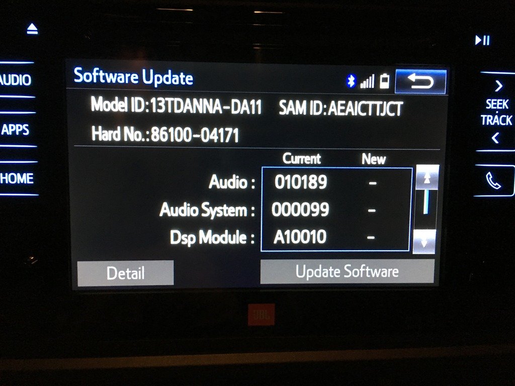

    I think it may have something to do with the Model Code. 13TDANNA-DA11 is the one shown on the Setup screen on my hea unit. I'm going to rewrite the OE184 image to the SD card again tomorrow (now that I know it can be recovered) and copy all the files over to Windows and do a comparison. I remember seeing different model codes on the OE183 files, and when I looked at the OE184 I wasn't paying much attention to the file names. I'm definitely not giving up that easy. @Hank Heel which head unit do you have? What's your model code, etc?

    Did any of the software update stick? Is it just the maps that wouldn't load? Are the "Audio" "Audio System" and "DSP Module" numbers the same?
