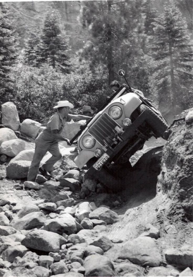

    35's give you one more measly inch of ground clearance compared to 33's. One and a half more than 32's and we won WW-2 driving Jeeps with 32" tires on them. Farmers, loggers, and construction workers who actually use their trucks get by just fine with 32" tires. There is this thing called driving skill that some try to replace with equipment
    If your goal is to get from point A to point B there are darn few places where a 32" tire and driving skills won't take you. That extra 1" to 1.5" of ground clearance comes at a huge expense and drivers have to seek out the hardest path in order to prove they can go somewhere others cannot.
    Around 33" is the point where the negatives start to outweigh the positives. Not all, but most of the guys running 35" tires are doing it just for the "Look". It is easy to tell them apart. The guys with big tires on daily drivers are mostly for show. The guys running 35 or bigger tires who are serious pull their vehicles to the trailhead on trailers.
    Doing it right involves a lot more than a lift and a regear. Tires that size done right involves highly modified vehicles with axles and other running gear out of 3/4 and 1 ton trucks under the frame.
