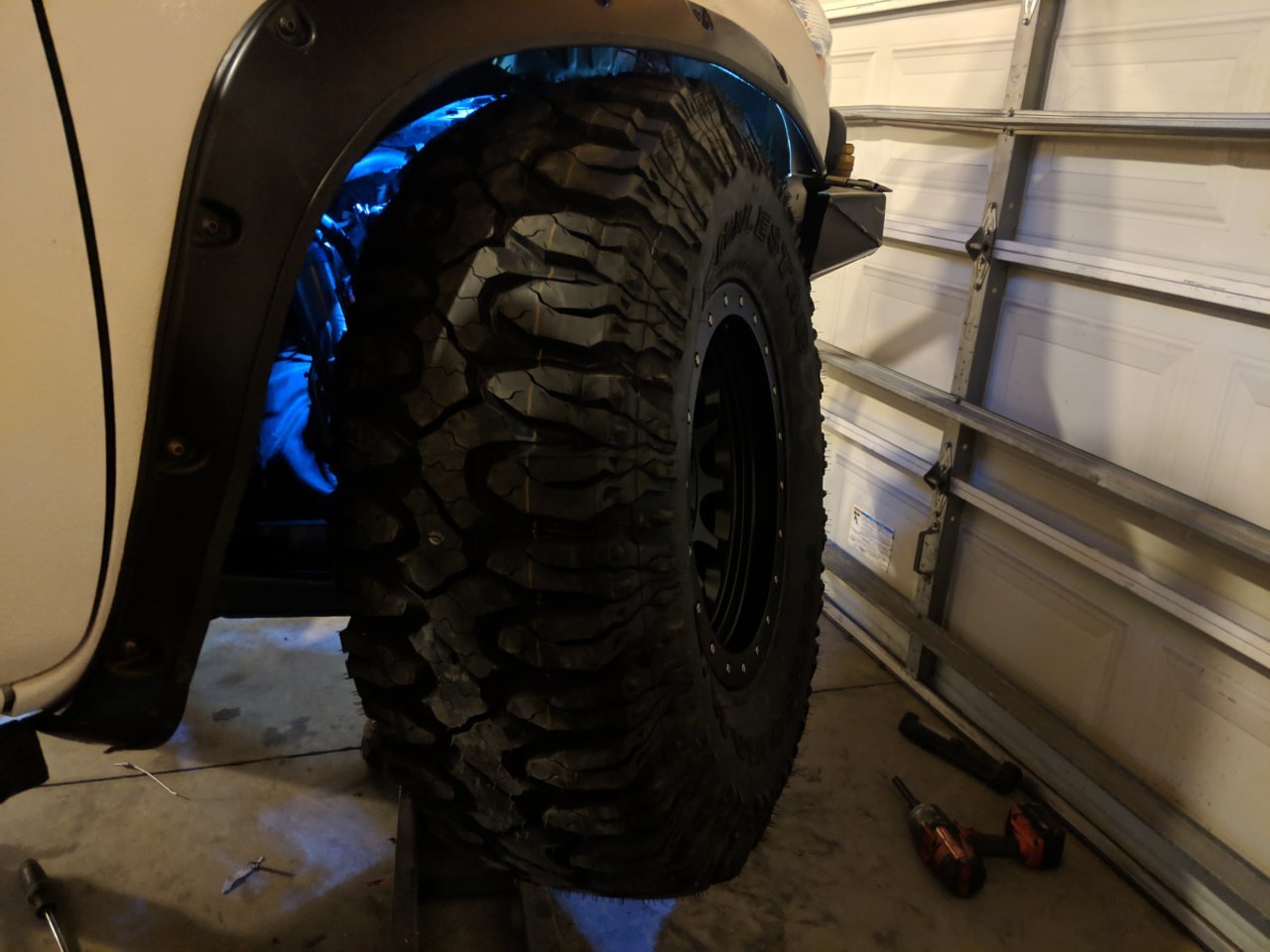

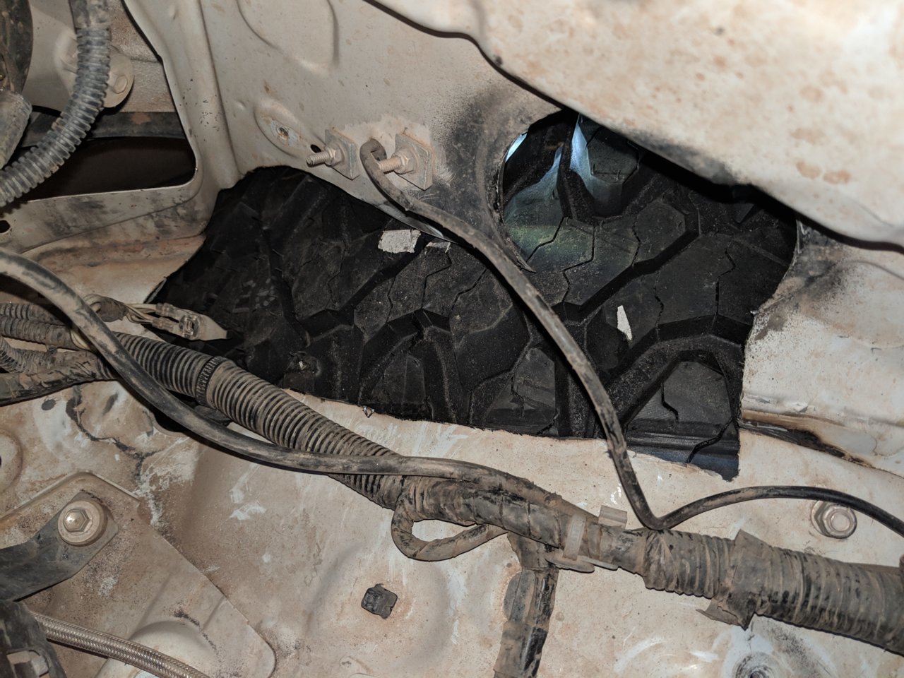

    Crawler guys have different standards for what is "fit". To them, they will do whatever it takes to stuff a bigger tire in, including gimping suspension travel.
    Front tubbing for 37s on my truck with a +2 kit. An additional 3/4 inch track width won't change much.
    There's no magic to fitting tires larger than 35s.... .you either put pucks in on your bump stops or you tub. Also consider that his kit pushes the wheel forward 1-2"...that will actually make the inference worse at the front of the wheel well for the sake of avoiding cutting the firewall.

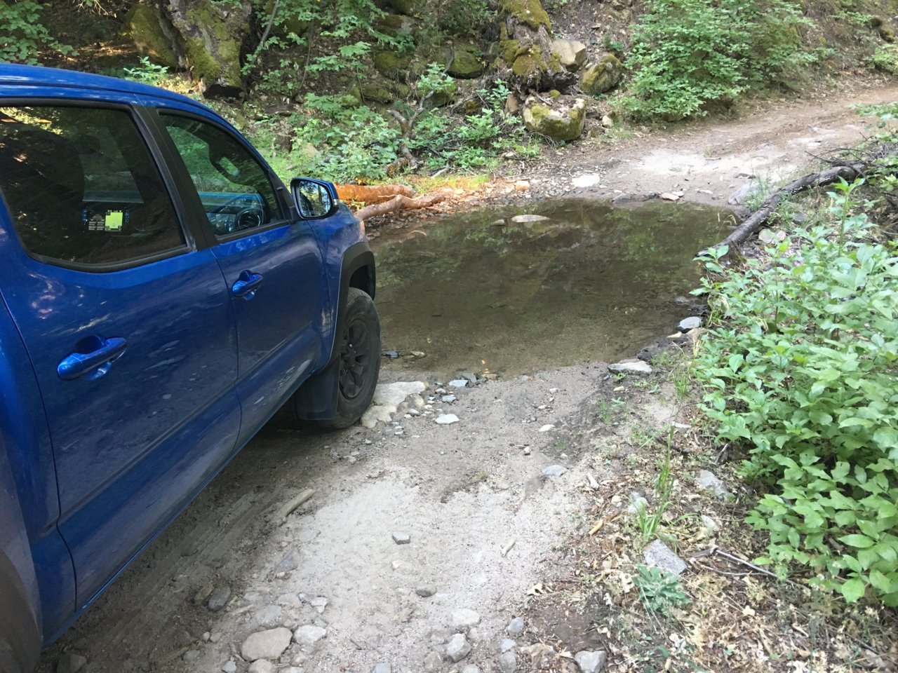

    wow...seriously? there are literally zero objects that would have remotely came close to "banging your undercarriage" in that last pic :facepalm:
    Better add a snorkel, just in case you encounter any more small puddles!
