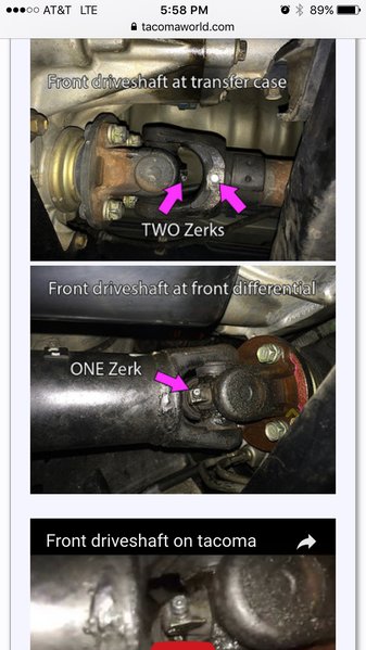

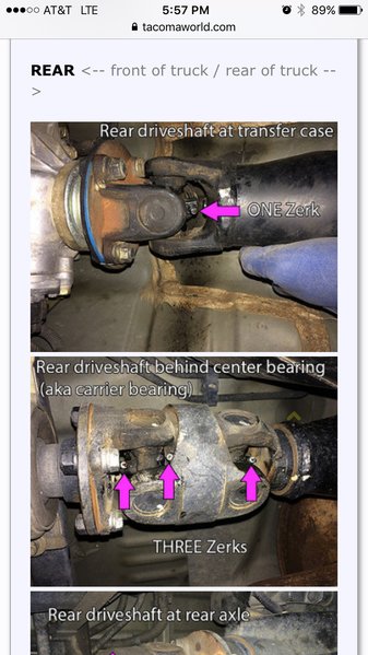

    I found this on TW. It's nothing to do with UCA's or LCA's but everything else

    @zippsub9, my brother, I love him!
    @Sicyota04 , thank you for that information. Very helpful!
