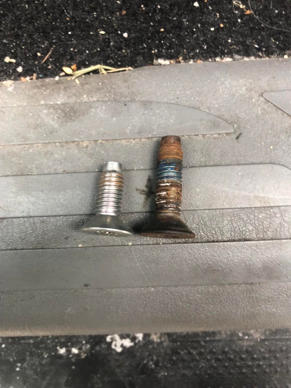

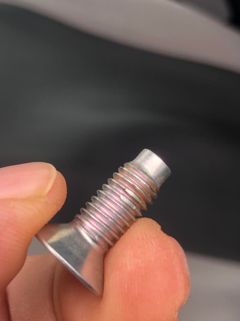

    So I got the new screw from the dealer and they don't have the original anymore. They said it was replaced with this new part # 90080-14055. Its shorter. It does screw into the 8mm 1.25 hole... But it does bind because there are cuts on the thread.....

    Looks like they made it stainless and shorter to avoid the threads from extending too far past the captive nut. Shouldn’t have the problem with it seizing up in there.

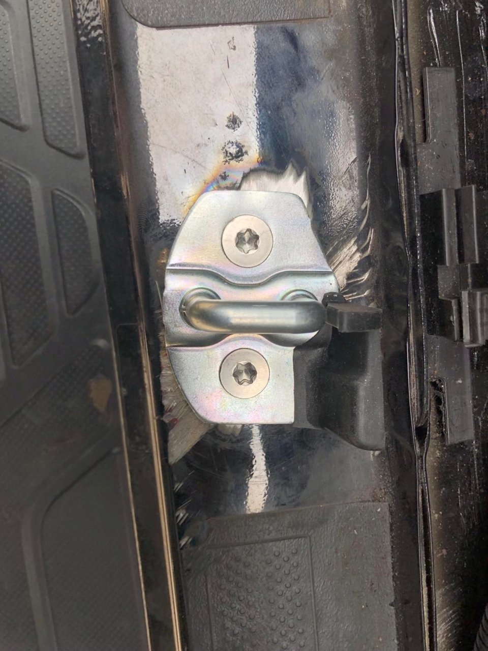

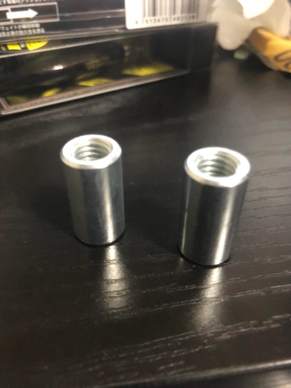

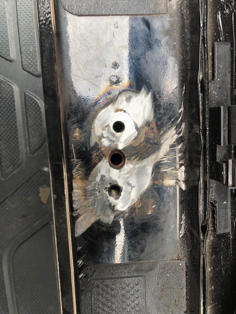

    Got some weld nuts and finally got someone to weld it in. Door shuts tight now. Just need to paint it.
