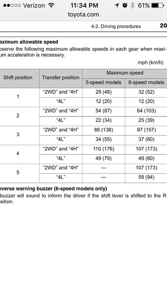

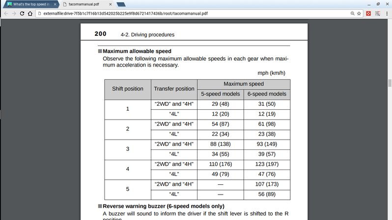

    Page 200 in the book.

    2017 for comparison

    Why is 2017 different? Add a few hundred rpm to the redline or gearing?

    Different rear end

    Really? I have heard no such thing. Got any sources?

    rear ends are the same for 2016 and 2017

    Toyota probably adjusted the fuel cut off for 2017. #lawyers
    Edit: or one is a sport and one is an or, and the fuel cut off is based on the stock tire rating?

    I mean gears not the physical rear axle
