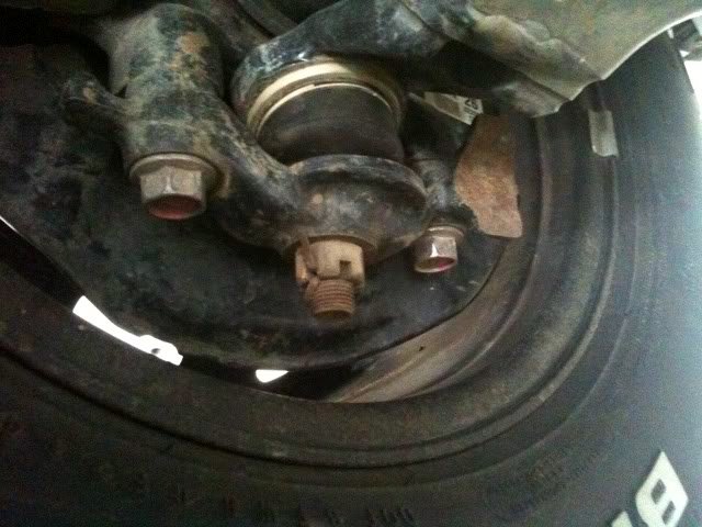

    Whats the torque for the 2 outboard bolts on the lower control arm on a 2nd gen taco. its the two bolts closest to the wheel on the bottom.

    I show 103 ft. lbs. for those bolts. Your welcome.

    I think that is the "Front Lower Ball Joint Attachment X Steering Knuckle" if so, its 118 ft. lbs.

    Damn that is tight as a mofo. Thanks guys

    I took them off to put on my suspension lift

    When you put on Bilstein's, it's easier to remove the lower ball joint, so you can pull the lower control arm down far enough to get the shock back in.

    thank god...i guessed and torqued mine to 120 after the lift. got lucky on that one lol
